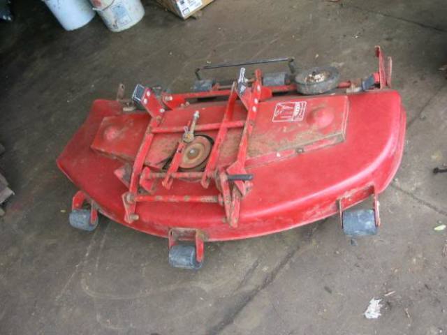

daveoman1966 3,883 #2 Posted August 25, 2016 (edited) Here is a 48" deck from a D-200. Notice the SLIGHT difference in the Tach-o-Matic lift hardware brackets...mainly the front one. Note that the lift hardware of a 42" Rear or side is the same for the C series tractors and that the only real difference between the D and C series is the lift hardware. I think the 05-42MS04 will work on the D series and you MAY have to change out some lift hardware....maybe not. Edited August 25, 2016 by daveoman1966 Share this post Link to post Share on other sites
