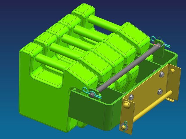

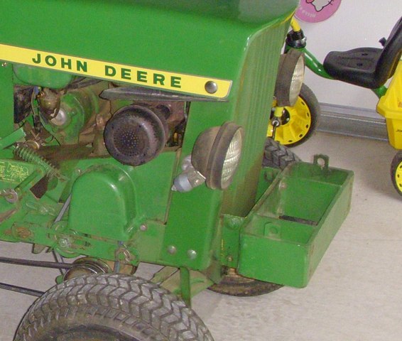

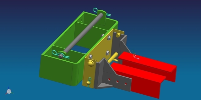

T-Mo-(Moderator) 4,855 #1 Posted August 24, 2016 I'm at work, so I can't measure the frame at the front of my 551. But, I was thinking about adding a front weight bracket. I currently have a front weight bracket on my 1966 John Deere 110 and have thought about modifying it to fit a Wheel Horse, and make it interchangeable to both the JD and a WH. I have a 3D model of the weight bracket, so if I had the frame dimensions of a 551, I can modify my 3D model to see if it would work. So If anyone can give me the dimensions of the frame at the front of a 551, that would be great. RF 110 Weight Bracket.pdf BTW, I would paint the bracket black so it would be more generic. 2 Share this post Link to post Share on other sites
rmaynard 17,247 #2 Posted August 24, 2016 If it's the same as my 701 it's 6.75". 1 Share this post Link to post Share on other sites
T-Mo-(Moderator) 4,855 #3 Posted August 24, 2016 13 minutes ago, rmaynard said: If it's the same as my 701 it's 6.75". Thanks. Share this post Link to post Share on other sites
wallfish 20,053 #4 Posted August 24, 2016 Not the same. All the ball burner frames are 6 inches wide. 1 Share this post Link to post Share on other sites
T-Mo-(Moderator) 4,855 #5 Posted August 24, 2016 7 minutes ago, wallfish said: Not the same. All the ball burner frames are 6 inches wide. Thanks. That will help. Share this post Link to post Share on other sites
Racinbob 12,996 #6 Posted August 24, 2016 I assumed they were the same but after John posted that I had to go measure. Yup, 6" on my 400, 6.75" on front engines. Share this post Link to post Share on other sites

wallfish 20,053 #9 Posted August 25, 2016 7 hours ago, bmsgaffer said: Would it make a difference since the 551 had the unidrive that none of the other nut roasters had? I dont have mine nearby but just double check. Nope, they're 6" wide 2 Share this post Link to post Share on other sites
T-Mo-(Moderator) 4,855 #10 Posted August 28, 2016 I can make the weight bracket to where it will interchange between my JD 110 RF and a Wheel Horse Suburban. 1 Share this post Link to post Share on other sites
