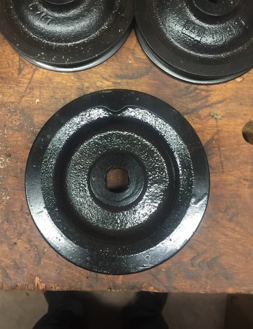

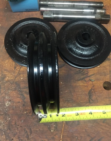

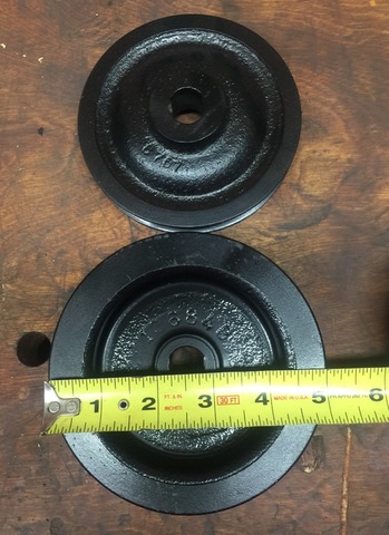

Aldon 4,832 #15 Posted August 24, 2016 Here is a pic of the double cast iron pulley off 48 inch deck and the single cast iron pulley above it for reference. the number on the double pulley is 106848. Numbers on the single cast pulleys are 8757. the second pic is the top view. the third pic is side view. Share this post Link to post Share on other sites
Aldon 4,832 #16 Posted August 24, 2016 Here is a pic of the double cast iron pulley off 48 inch deck and the single cast iron pulley above it for reference. the number on the double pulley is 106848. Numbers on the single cast pulleys are 8757. the second pic is the top view. the third pic is side view. i also sent you a PM. Share this post Link to post Share on other sites
