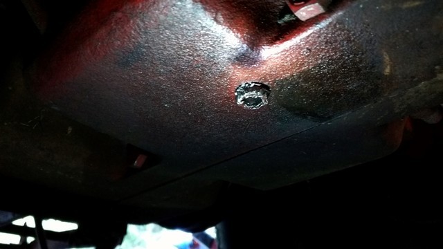

Harvest2112 9 #1 Posted August 22, 2016 Howdy folks First, let me say that this forum has been indispensable to me since I purchased a 312-8 last summer. Thank you all for your fantastic community here and your continued support for Wheel Horse owners. I attempted to change my trans oil this past weekend. I tried a 3/8" Allen wrench but it did not have the torque necessary to free the bolt. I went to the hardware store and purchased a 3/8" hex bit for my socket wrench and let PB Blaster soak on the bolt for an hour or so. I tried to crack it loose and ended up stripping the head of the bolt. What do you guys think I should try to get it out? I read somewhere that you can hammer a slightly larger star bit into the reamed hole and try to break it loose that way. I have nothing to lose at this point so I am open to any other suggestions. I figured that heating the bolt would be a recipe for catching my tractor on fire but maybe it would work if done carefully? Not sure. Thank you in advance for any advice you can throw my way - Chris Share this post Link to post Share on other sites
stevasaurus 23,816 #2 Posted August 22, 2016 drilling through the plug and using an "easy out" should do the trick with out messing up the threads. 4 Share this post Link to post Share on other sites

oldredrider 2,553 #4 Posted August 22, 2016 Get a HIGH QUALITY set. The cheapies will break off and that will compound the problem. 3 Share this post Link to post Share on other sites

953 nut 68,773 #7 Posted August 23, 2016 The plug was probably cross threaded and is jammed. You could drill it out with progressively larger drill bits until all that is left is a thin shell and the threads; use a small punch and collapse the threads inward. 2 Share this post Link to post Share on other sites

Jake Kuhn 1,600 #11 Posted August 23, 2016 If there are still threads sticking out which there normally is,I've gotten lucky sometimes removing them with a pair of vise grips on the thread.Yes,you will damage the threads but it sounds like your plug needs replaced anyway. 3 Share this post Link to post Share on other sites
Harvest2112 9 #12 Posted August 23, 2016 There are still a few rows of threads visible, maybe I can get a vice grip on there. I already own a pair of them so that would be the cheapest option. Good tip, thanks Do any of you guys happen to know what the part number of the drain bolt is? I don't have my serial number handy to do a parts lookup to get a replacement but I will get it at home tonight, didn't know if anyone had that number handy though. Thanks again guys. Share this post Link to post Share on other sites

953 nut 68,773 #15 Posted August 23, 2016 3 hours ago, Harvest2112 said: any of you guys happen to know what the part number of the drain bolt is? It is just a 1/4" pipe thread plug, you can get them at any hardware store. 3 Share this post Link to post Share on other sites
Harvest2112 9 #16 Posted August 23, 2016 I didn't realize it was a common/multi-use part. Thank you! Maybe I can find one that has something different than a hex head to avoid this problem in the future. 2 Share this post Link to post Share on other sites
stevasaurus 23,816 #17 Posted August 23, 2016 Should be able to find one that has a 1/4" square head sticking out so you can use a small crescent on it. They also come in brass rather then cast iron. Share this post Link to post Share on other sites
squonk 47,986 #18 Posted August 23, 2016 If you don't get it out get one of those oil sucking units and drain it from the fill hole. Better than nothing. 1 Share this post Link to post Share on other sites
cleat 9,286 #19 Posted August 23, 2016 If you are going to put a blade or tiller on it make sure you get a plug that sits nearly flush as the original does. A standard pipe plug will hit the bar that latches into the rear hitch (don't ask how I know). If not, a regular pipe plug is the way to go. 2 Share this post Link to post Share on other sites
Harvest2112 9 #20 Posted August 24, 2016 I put the vice grip to it yesterday afternoon but that sucker wouldn't budge no matter how much force I used. I ended up ripping up the bolt a bit. I'm going to get an easy out tomorrow and, failing that, drill it out how 953 Nut said. Thanks Chris 2 Share this post Link to post Share on other sites
DougC 2,644 #21 Posted August 24, 2016 Looks like there is enough sticking out to be able to use a pipe wrench on it. The harder you pull the tighter it grips. Even a small pipe wrench with a section of pipe slid over the handle should be plenty of force to move that small plug. I've removed rusted trailer hitch balls that have been on step bumpers for 20 years with a pipe wrench and a 4 foot section of steel pipe slid over its handle as a strong arm. Use the drill and easy out as a last resort. Share this post Link to post Share on other sites
wallfish 20,547 #22 Posted August 24, 2016 Weld a nut to it and take it right out with socket. The heat will also break loose the bond it has to the case. Good reason to buy a welder if you don't have one! Then you'll be amazed how many things you'll find that need welding (or even things you make up that need welding) 3 Share this post Link to post Share on other sites

lynnmor 9,025 #24 Posted August 24, 2016 Is there any "guts" in there that a drill or easy-out might damage? I looked for a socket type drain plug at local hardware stores with no luck. Yes, the plug needs to be nearly flush to clear some rear hitching. 1 Share this post Link to post Share on other sites
