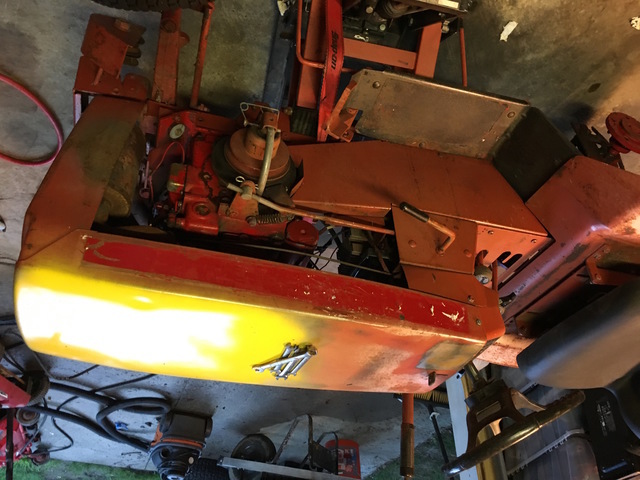

DougQT 16 #26 Posted August 22, 2016 Thanks everyone. I'm kind of relieved in a way, because I was on the fence about giving my dad a "rattle-can-rebuild" on someone else's info, vs. just going through the motor myself. I've never done one of these before, but I am familiar with working on cars. If it were an old school 3.0 Chrysler motor I would be fine. I don't have a big enough property to mow, so the last Wheel Horse I spent time on was washing and waxing my dad's c-101 when I was 10 years old 26 years ago. Sorry if the photos are flipped. Not sure how to fix that. 1 Share this post Link to post Share on other sites

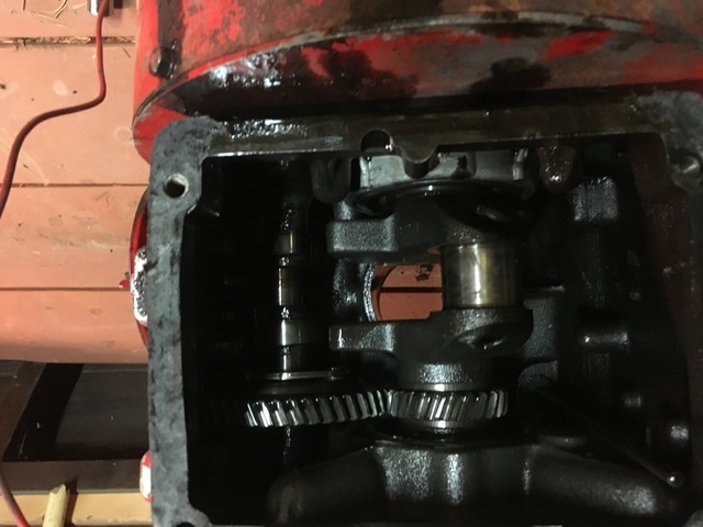

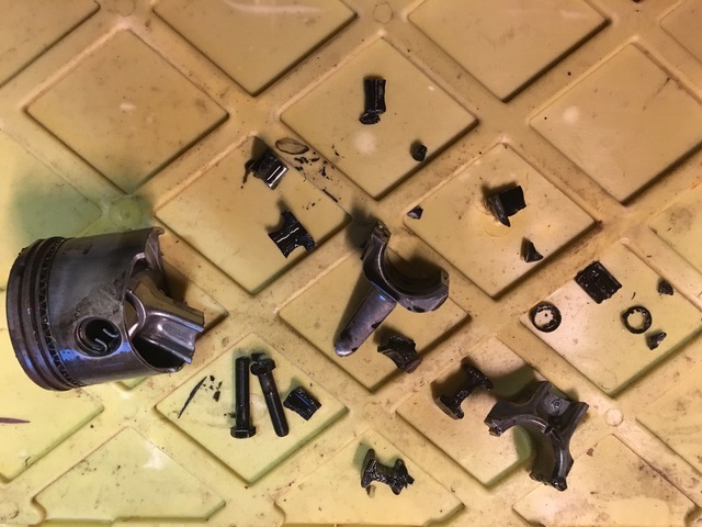

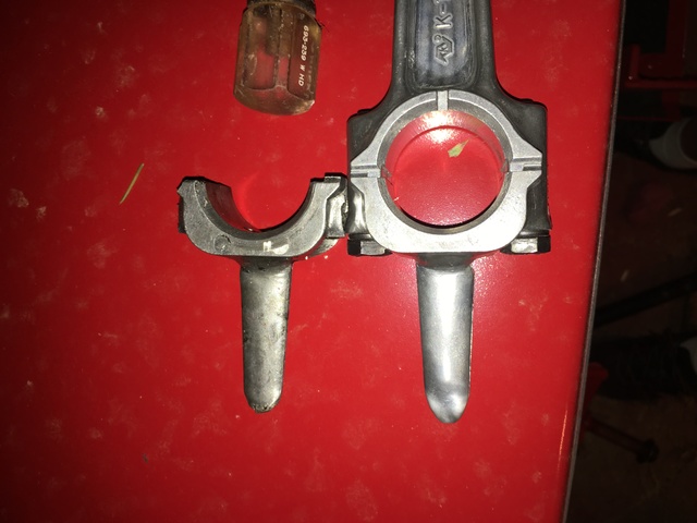

DougQT 16 #27 Posted August 27, 2016 (edited) So got the motor out and pulled the pan. It was full of small pieces of connecting rod, but the cam is in tact and the crank journal and cylinder wall are smooth as can be. Does the rod just ride on the crank, or is there a main bearing? Didn't see any in the shrapnel. Looking at ordering the rebuild kit shown earlier in the thread. Should I just get the standard sizes and just hone the cylinder? Everything seems clean. Advice? Edited August 28, 2016 by DougQT 1 Share this post Link to post Share on other sites
Ed Kennell 46,244 #28 Posted August 28, 2016 No crank/rod bearing. The aluminum rod rides on the steel crank. You need to verify the crank journal OD and cylinder ID before ordering a new rod and piston. If they are in spec and the surfaces are good, you may get by with standard size parts and no machining. Are you sure there is no aluminum smeared on the crank? 1 Share this post Link to post Share on other sites
DougQT 16 #29 Posted August 28, 2016 (edited) There is nothing on the crankshaft journal. It is smooth and clean as can be. Cylinder wall is clean and smooth too. Going to hone it and mic it to just to check. I have pics of the crank and cam, but there is some size limit on uploads so I can't post them. Sorry. Thanks for all the help. Edited August 28, 2016 by DougQT 2 Share this post Link to post Share on other sites

Thisguyisnew 114 #35 Posted August 29, 2016 Any of you guys know what causes this type of failure? I have a c160 with a very similar story and never figured out why it failed under the previous owner? Just curious Share this post Link to post Share on other sites
Ed Kennell 46,244 #36 Posted August 29, 2016 (edited) Low oil level, Dirty oil, and operating on hilly terrain. Edited August 29, 2016 by Ed Kennell 2 Share this post Link to post Share on other sites
Thisguyisnew 114 #37 Posted August 29, 2016 Don't know if blocked air fins are also a cause but when shroud came off there was tons of mud packed inside them. Share this post Link to post Share on other sites
953 nut 66,688 #38 Posted August 29, 2016 32 minutes ago, Ed Kennell said: operating on hilly terrain Bought a parts tractor with a blown motor, seller had always mowed up and down a large sloped lawn for years, his son mowed across it twice and it threw a rod; the splash dipper wasn't getting into the oil with it tilted to the side like that. 1 Share this post Link to post Share on other sites
Thisguyisnew 114 #39 Posted August 29, 2016 (edited) I'm of the opinion and I am sure my engine agrees with me that once is enough and we don't want to do that again. Thanks guys Just wanted to clarify. It was the best experience for me getting to work on one. I guess I should thank the previous owner in a way Edited August 29, 2016 by Thisguyisnew Share this post Link to post Share on other sites
