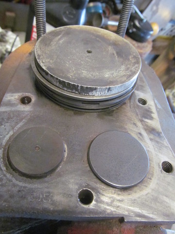

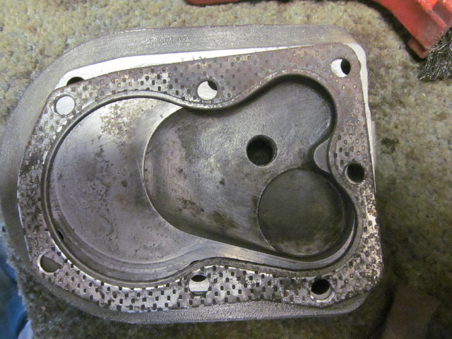

DougQT 16 #9 Posted August 21, 2016 Ok, so the pulled the head and spun the flywheel, and piston doesn't move. How bad a shape am I in. I am very mechanically inclined, but have never torn down tractor engine. Difficulty rating? Special tools required? I have access to a second engine, but it smokes, so I would probably have to do at least rings on the other one. Share this post Link to post Share on other sites
Elkskin's mower junkyard 1,117 #10 Posted August 21, 2016 2 minutes ago, DougQT said: Ok, so the pulled the head and spun the flywheel, and piston doesn't move. How bad a shape am I in. I am very mechanically inclined, but have never torn down tractor engine. Difficulty rating? Special tools required? I have access to a second engine, but it smokes, so I would probably have to do at least rings on the other one. broken rod 1 Share this post Link to post Share on other sites
DougQT 16 #11 Posted August 21, 2016 Yup. How hard is it to fix? Share this post Link to post Share on other sites

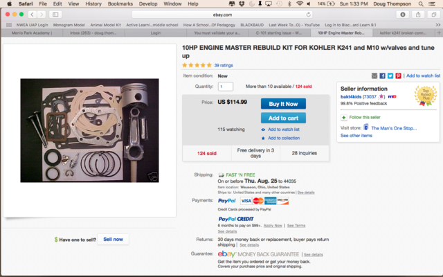

DougQT 16 #13 Posted August 21, 2016 This what I would need? Could the broken rod have damaged anything else? The cylinder wall looks nice and clean. it is not seized. Tapped the piston with my finger and it dropped 1/2 an inch. 2 Share this post Link to post Share on other sites
Elkskin's mower junkyard 1,117 #14 Posted August 21, 2016 should be it. pull engine pop pan inspact everything alot of time when rod blows it takes cam with Share this post Link to post Share on other sites
953 nut 70,333 #15 Posted August 21, 2016 2 minutes ago, DougQT said: This what I would need I think you will want to pull the engine down prior to ordering parts. Chances are that kit will do the trick, but you will want to measure the crank and cylinder first. I have used kits from "bakt4kids and they are great. 2 Share this post Link to post Share on other sites
DougQT 16 #16 Posted August 21, 2016 What does it do to the cam? Is that difficult to replace? Is any machine work necessary to install that rebuild kit assuming the broken rod did not damage anything else? Sorry, lots of questions. 1 Share this post Link to post Share on other sites

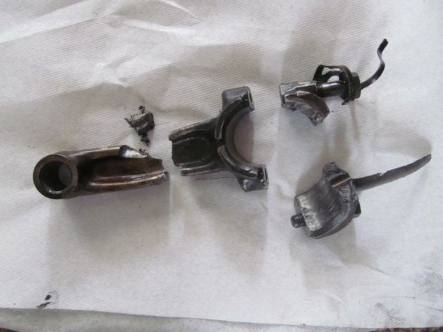

Ed Kennell 47,818 #17 Posted August 21, 2016 Here is what I found inside my 875. all that I replaced was the $27 rod. The piston, cylinder, and wrist pin all measured within specs. It did take a lot of rubbing to get all the aluminum off the crank, but I did not have to remove the crank to do this...just the head and the pan. Clean, clean, and clean. Be careful not to scratch the head and block in the head gasket area when you remove the carbon. Share this post Link to post Share on other sites
953 nut 70,333 #18 Posted August 21, 2016 If your cylinder is not badly worn or out of round and the crank shaft was not damaged you will be able to do the job with standard tools, augmented by a hone for the cylinder and a torque wrench. If the valves are to be replaced you will need a valve spring compressor and a valve lapping tool. Probably the special tools can be rented or borrowed from an auto parts store like Advance Auto Parts. Like Ed said, take it apart and inspect everything before you buy your parts. 1 Share this post Link to post Share on other sites
