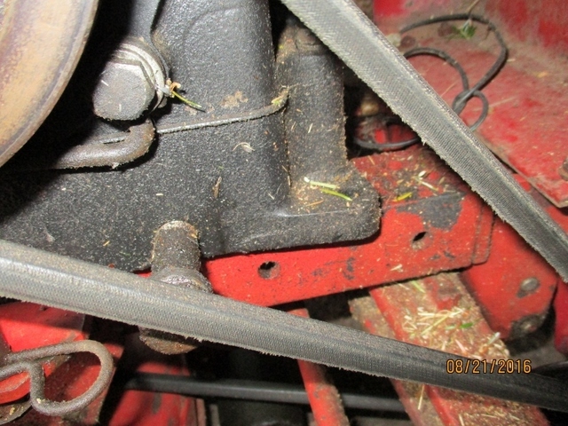

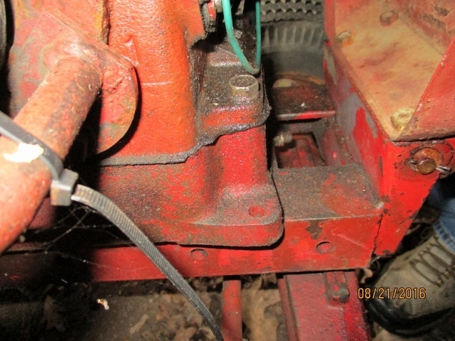

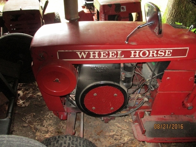

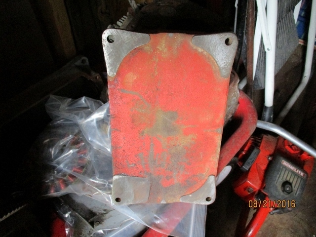

N3PUY 1,031 #4 Posted August 21, 2016 Here's pics of 3 different tractors with 12HP motors. But there are pans that do not have the tapped holes in the bottom to put bolts from the bottom up. I found that out this summer !!!!!! If no tapped holes then use J-bolts. Share this post Link to post Share on other sites

N3PUY 1,031 #7 Posted August 21, 2016 21 minutes ago, Ed Kennell said: I was not aware there are pans without the tapped mounting holes. But If I had one, I would make two angle brackets bolted to the frame and the ears on the pan. Just not a fan of J-bolts on cantilevered cast iron ears. Yep.... made the motor transplant a little more difficult ... had to change pans. 1 Share this post Link to post Share on other sites
Larry Chamberlain 29 #8 Posted August 21, 2016 I have the pan that has the tapped bottom holes Share this post Link to post Share on other sites

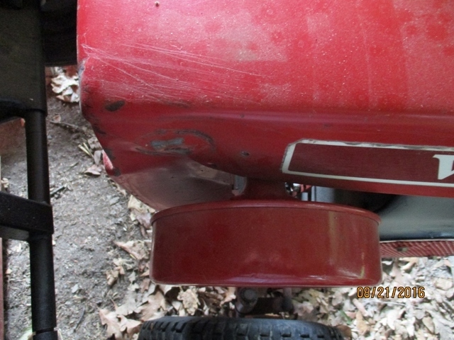

N3PUY 1,031 #11 Posted August 21, 2016 I think it's a GT14 air filter. That's what is on my C101. The motor is off a Gravely .... probably why it didn't have the tapped holes. And the air cleaner is off a GT14. I wasn't sure if it was going to fit but it was perfect! ¼" clearance top and front. It will still be OK after the dent in the hood gets straightened. 2 Share this post Link to post Share on other sites
Larry Chamberlain 29 #12 Posted August 21, 2016 Gt14 sorry not gt40 lol yeah your frame looks little longer than mine Share this post Link to post Share on other sites
N3PUY 1,031 #13 Posted August 21, 2016 4 minutes ago, Larry Chamberlain said: Gt14 sorry not gt40 lol GT40 are Ford cylinder heads! Share this post Link to post Share on other sites
oldredrider 2,553 #14 Posted August 21, 2016 A rear view mirror on a C-101...How cool is that!!! 1 Share this post Link to post Share on other sites
N3PUY 1,031 #15 Posted August 21, 2016 2 minutes ago, oldredrider said: A rear view mirror on a C-101...How cool is that!!! Yep .... and it's a factory mirror! Harley factory! Share this post Link to post Share on other sites
