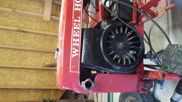

Larry Chamberlain 29 #1 Posted August 21, 2016 I'm trying to stuff a 12 Kohler under the hood of my 8 go 4 speed wheel horse but running into some issues I'm sure someone in here has done this please chime in thanks Share this post Link to post Share on other sites
oldredrider 2,553 #2 Posted August 21, 2016 It would help if you described the issues...... Share this post Link to post Share on other sites
Larry Chamberlain 29 #3 Posted August 21, 2016 sorry mounting the oil pan I need to be all but touching the battery tray but I can't drill the front holes cause if the steering mount for the tie rods Share this post Link to post Share on other sites
kudzu3 323 #4 Posted August 21, 2016 What tractor do you have? Share this post Link to post Share on other sites
Larry Chamberlain 29 #5 Posted August 21, 2016 8hp 4 speed it's a 73 Share this post Link to post Share on other sites
kudzu3 323 #6 Posted August 21, 2016 Do you know the model of the tractor. I'm thinking the 12 should hook right up, but I'm certainly not an expert. Share this post Link to post Share on other sites

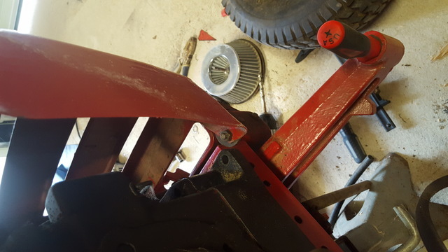

Larry Chamberlain 29 #7 Posted August 21, 2016 Aolt of cleaned issues yes it hooks right up I had to notch the lower corner of the hood so I clears the oil pan ear now the issue with the air cleaner I'm just gonna have to notch the side I bought a gt14 air cleaner neck so I can mount out the side but gotta take a good chunk out the side of the hood 1 Share this post Link to post Share on other sites
kudzu3 323 #8 Posted August 21, 2016 Sounds like you may have it figured out Larry, how about some pictures 1 Share this post Link to post Share on other sites

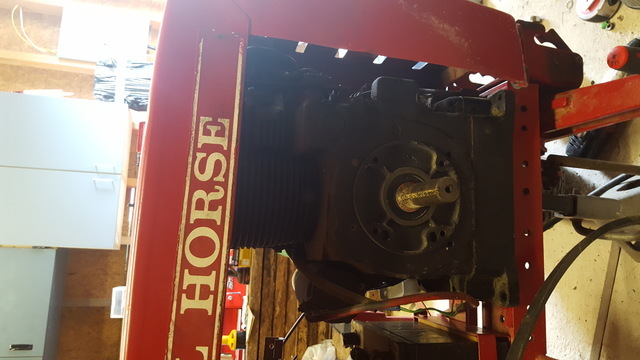

kudzu3 323 #10 Posted August 21, 2016 Wow, that is tight! Surely someone here has done this, I'd sure like to see how it was done. Share this post Link to post Share on other sites
19richie66 17,930 #11 Posted August 21, 2016 Couldn't you have mounted the motor further back and move the battery to the front? Not next to a tractor at the moment. Just a thought. Share this post Link to post Share on other sites
skrusins 128 #12 Posted August 22, 2016 Has the frame be altered ? There are a lot of holes drilled in the side from what I see. It's not standard. Share this post Link to post Share on other sites
kudzu3 323 #13 Posted August 22, 2016 I searched 1973 wheel horse tractor images and looking at the 8 hp, there's just not enough room in there for a 12. The 8 hp engine sets forward, almost against the hood grill. Looking at the pictures, the frame seems to be stock, the holes are there. I think that tractor just wasn't made to for a bigger engine without a lot of alteration. Keep us posted Larry, interesting project. Share this post Link to post Share on other sites
Larry Chamberlain 29 #14 Posted August 22, 2016 I got the hood all notched out did I dry fit up of the clutch and belt everything seems to be good gotta send the block to machine shop with the piston to get bored 10 over 1 Share this post Link to post Share on other sites
kudzu3 323 #15 Posted August 23, 2016 Glad to hear things are fitting, May be a good idea to check the crank too, I had one re built a few years ago and when I got it all together and cranked it up, it had a slight knock. Had to take it all down and have the crank turned . 1 Share this post Link to post Share on other sites
