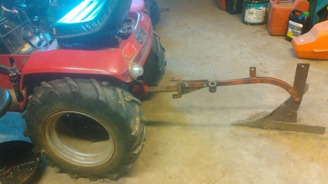

grine_22 145 #1 Posted August 20, 2016 I have a moldboard plow I acquired and I put it behind the 310-8, it will work fine in tilled ground but trying to use it on unworked soil it does not seem to have down pressure to pull itself in the ground. If i lean back and push on it it digs great but when i leave off it just pulls out of the ground. What are options to solving this problem? Share this post Link to post Share on other sites
gwest_ca-(File Mod) 12,511 #2 Posted August 20, 2016 If you want to plow 5" deep put the left front and rear wheels up on 5" blocks. Now adjust the plow to sit flat on the floor like it is now. There should be an adjustable link joining the rear vertical bar to the bracket on the plow frame. What it adjusts is called the suck. It pulls the plow into the ground until the angle iron at the rear called the land slide won't let it go any deeper. This process will get your adjustment real close to what you want. If you want to go deeper tip the point down. To raise it a bit raise the tip a bit. Garry 4 Share this post Link to post Share on other sites
953 nut 69,841 #3 Posted August 21, 2016 This is the adjustment Garry was talking about. 1 Share this post Link to post Share on other sites
squonk 48,231 #4 Posted August 21, 2016 Looks like the adjuster link for the plow is missing. 1 Share this post Link to post Share on other sites

Shynon 7,723 #8 Posted August 21, 2016 (edited) When you get an adjustment link, set the tail of the landslide 1" off the floor as the tractor sits. Actually as a look at the picture again, if the mounting bar is welded straight on the plow it may not work at all. If you look at a Brinly plow the front hitch is welded on at an angle so the shear is flat in the bottom of the furrow as the tractor is at an angle. Edited August 21, 2016 by Shynon 1 Share this post Link to post Share on other sites

PeacemakerJack 11,074 #12 Posted August 21, 2016 I'm glad to see you have picked up a plow for your GD WH. Your plow it missing the above mentioned adjusting link and also a coulter. The coulter is optional on this size plow although I prefer to run one as often as conditions will allow. An adjusting link is necessary. Brinly has a free downloadable manual for their plows on their website. I suggest downloading and reading it through carefully. Your plow is of a different manufacturer and therefore all details won't be the same but the concepts of how to properly set up a plow for plowing, how to strike out a plot, how to make adjustments while plowing, dealing with various types of ground conditions, and many more little gems are contained therein! Some of the points the guys listed above will be found in there with much more. Plowing is very addictive so be careful As to durability, my dad beat his 875 hard enough to break a gear or two, but that was a one time event out of literally dozens upon dozens of times playing in the dirt. Good luck and keep us posted on what you come up with. Share this post Link to post Share on other sites
grine_22 145 #13 Posted August 21, 2016 I have the adjuster link, and the Coulter, just had them off when I took the picture. 1 Share this post Link to post Share on other sites
T-Mo-(Moderator) 4,979 #14 Posted August 21, 2016 How to adjust a single moldboard plow and more plow information: Plow_Operation.pdf brinly plow.pdf plow_setup.pdf 2 Share this post Link to post Share on other sites

grine_22 145 #16 Posted August 21, 2016 The plow is at an angle where I welded it to my bracket, like I said I don't understand how it'll work fine in my garden but not in the grass. I don't know if adding some weight will help I just don't want to stress my lift cable Share this post Link to post Share on other sites
