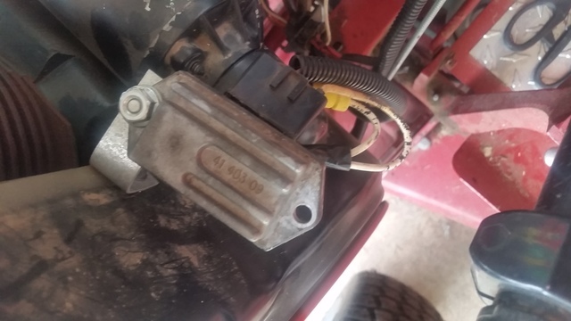

Texas Todd 1,026 #1 Posted August 20, 2016 On my 312-8, I repowered with a brand new 1976 era K341 my neighbor has had since the 70's. Since I had to use the housing from my magnum engine (It had no housing), I also had to use my stator and cam bearing plate. The tractor originally had the electronic ignition and the old K341 is coil and points. I am using the small voltage regulator, pictured(I have tried 2 different ones). The voltage is all over the place. I have a video attached that shows what the multimeter does. It jumps all over the place faster than you can blink an eye, no constant reading. Is the voltage regulator wrong? The volt gauge on the tractor has never worked, but it has power to it. New volt gauge coming tomorrow. Not sure what to do. Same thing when you put the multimeter on the battery, the readout goes bonkers. The tractor seems to run just fine. It does seem to blow fuses after running a while (heat? backfeeding somehow?) Suggestions? 20160820_142248.mp4 Share this post Link to post Share on other sites
squonk 48,164 #2 Posted August 20, 2016 I have had the same problem on many tractors using a digital mutimeter. Didn't make a difference if I used a cheapie meter or my Fluke. I had to break out my old Simpson analog meter to get an accurate reading. Share this post Link to post Share on other sites
Texas Todd 1,026 #3 Posted August 20, 2016 Well, I wondered.....But my 1056 shows a straight 12.5 12.7 on the same multimeter and the mounted gauge is very steady. When I get the new volt gauge tomorrow, I expect that needle to go haywire..... Share this post Link to post Share on other sites
squonk 48,164 #4 Posted August 20, 2016 1056 uses a dc generator as opposed to the 341 with the ac producing alternator with a rectifier. That's why you get a steady reading. Share this post Link to post Share on other sites
Texas Todd 1,026 #5 Posted August 20, 2016 My 1056 was re-powered with an M10 though. Electronic ignition. I had an old analog meter, but can't find it. Will pick up another and let ya know what it says. Thank you! Share this post Link to post Share on other sites
Texas Todd 1,026 #6 Posted August 21, 2016 Well, the analog meter held steady at 13.5 or so. Thanks for the advice! I guess the gauge will hold steady as well. I noticed the hour meter only works with the volt gauge circuit completed. Found that interesting too. Thanks again. Share this post Link to post Share on other sites
