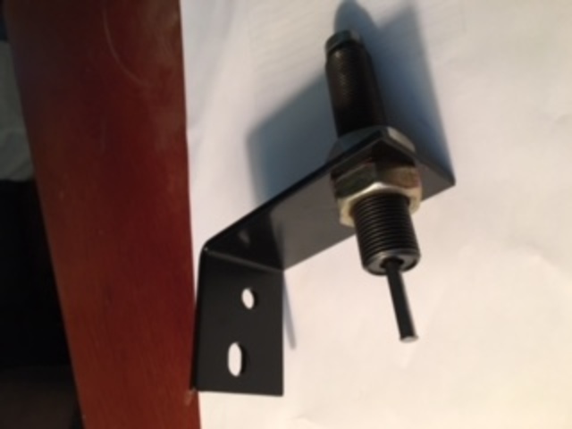

Maxie 9 #1 Posted August 17, 2016 (edited) Could someone please tell me what this part is and show me where it goes? I took it off my tractor 2 years ago when I started fixing it up and I can't remember where it goes. (It's an age thing.) Thanks. Edited August 18, 2016 by Maxie 1 Share this post Link to post Share on other sites

gwest_ca-(File Mod) 12,533 #3 Posted August 17, 2016 Is it item 53 on this page? Clutch damper https://www.partstree.com/parts/toro/mowers-lawn-garden-tractor/31-12k801-312-8-toro-312-8-garden-tractor-1990/clutch-brake-and-speed-control-linkage/ Garry 2 Share this post Link to post Share on other sites
illinilefttackle 399 #4 Posted August 17, 2016 Leave it off- but use common sense in how quickly you let out the clutch-Good Luck- Al Share this post Link to post Share on other sites
elcamino/wheelhorse 9,363 #5 Posted August 17, 2016 I have been working on my 416-8 and wondered what the heck it was. Will it hurt and anything if I don't replace it ? Share this post Link to post Share on other sites
gwest_ca-(File Mod) 12,533 #6 Posted August 18, 2016 This style is just an air shock. I washed the dust and dirt out of it and it works good. There is a spring in it so lubed with real light oil to stop rust. The oil does attract more dust but easy to wash out. Garry Share this post Link to post Share on other sites
Maxie 9 #7 Posted August 18, 2016 It's for a 1991 312-8 Classic. Share this post Link to post Share on other sites
gwest_ca-(File Mod) 12,533 #8 Posted August 18, 2016 3 minutes ago, Maxie said: It's for a 1991 312-8 Classic. The 1991 models show a high pressure gas shock. The photo you posted is the style shown for 1990. Garry Share this post Link to post Share on other sites
Maxie 9 #9 Posted August 18, 2016 That's the part Garry. Thanks for your help guys. Now that I see where it goes and remember taking it off now. 1 Share this post Link to post Share on other sites
jackhammer 553 #10 Posted August 18, 2016 Darn it Garry now I have to looking if I have one on my 90. Never noticed anything like that. Rick 1 Share this post Link to post Share on other sites
Racinbob 13,286 #11 Posted August 18, 2016 That is one of the methods they used to try and prevent sudden engagement. It's just one of the many safety devices that were added as the years went by. I had a hydraulic damper on my 2005 and it drove me nuts. I can't recommend removing any safety device but on my tractors I just use the spring that has worked well for decades. 4 Share this post Link to post Share on other sites
