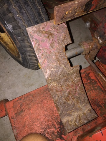

russellmc301 601 #1 Posted August 17, 2016 (edited) i have found feet rest for my project but the thing is one of the rest has a square cut out of it, any ideas on how to fix it? Edited August 17, 2016 by russellmc301 Share this post Link to post Share on other sites
benji756 342 #2 Posted August 17, 2016 if you can find a piece of matching metal you can square up the cut out and weld in the new piece Share this post Link to post Share on other sites
857 horse 2,588 #3 Posted August 17, 2016 (edited) Benji is right.!!!! Its just Diamond plate..it is possible to make a new one as well,,,,,,,,,,,Thank goodness its not the cast iron one !!! Edited August 17, 2016 by 857 horse Share this post Link to post Share on other sites

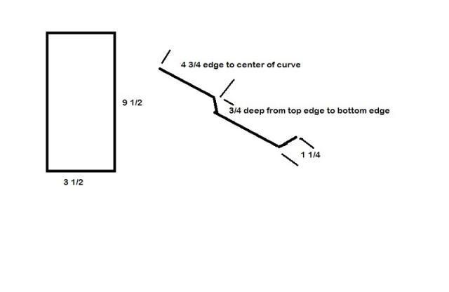

russellmc301 601 #4 Posted August 17, 2016 i think it would almost be easier to make new. what do you guys think 2 Share this post Link to post Share on other sites
ACman 7,722 #5 Posted August 17, 2016 Making a new one would be pretty easy . Bench vice , maybe a little heat . Or if you like a challenge , just fill it in with scrap metal . Then with some welds make your X's in the appropriate places . Using a grinder / die grinder , shape the X's so they look factory . A little time consuming , but a fun project , and a original piece saved . 3 Share this post Link to post Share on other sites
953 nut 66,540 #6 Posted August 18, 2016 Make a couple of new ones. 5 Share this post Link to post Share on other sites
