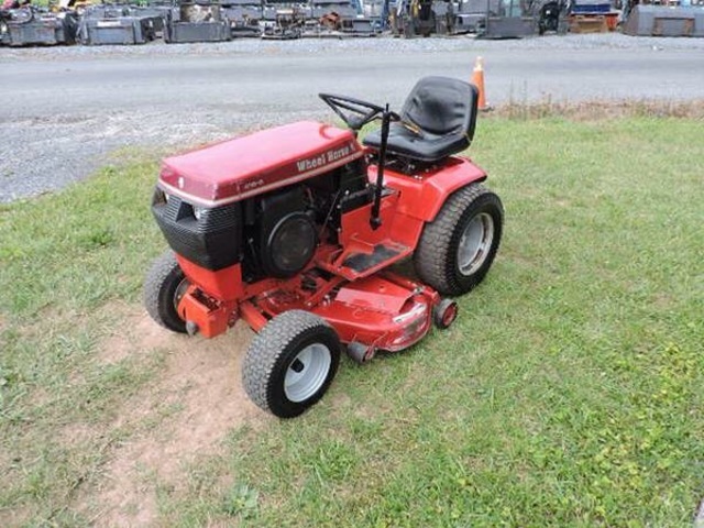

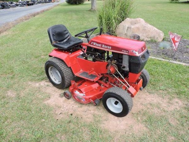

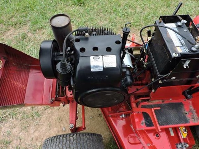

Hey all, I have found a wheel horse 416-8 for sale. I was wondering what you all could tell me about them in general. I am mainly looking to turn this into a pulling tractor, would this be a good one to do so with? If not, what would you recommend?  Also could you tell me what you know about the engine, it has a Koehler 341S one cylinder engine. Many thanks!!!!!

in my opinion that is one of the best wheelhorses ever made,single 16 horse kohler,and the stout 400 series tractor with the 8 pinion 1 1/8 axles,it would make a great puller

416-8? Great Horse! Total agreement with can whlvr.

Having the K-341 in it, makes it a 1985 or 1986.  Starting in 1987 the 416-8 had a Kohler M16S Magnum in them, as does my 1988 416-8.  The mid to late 80s Wheel Horses were considered the maroon striped Wheel Horses due to the maroon decal striping on the hood.
