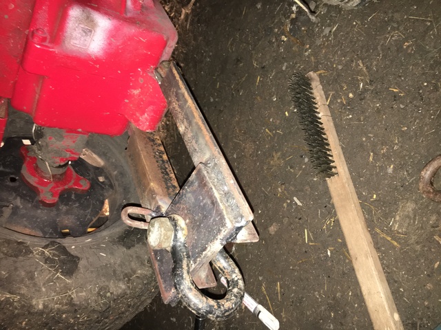

Loganthedoctor 9 #1 Posted August 16, 2016 Needed a hitch and didnt want to spend any $$$ on it so grabbed some scrap steel from my pile and threw this hitch together Also threw on a front tow point and started making a front hitch point 4 Share this post Link to post Share on other sites
857 horse 2,588 #2 Posted August 16, 2016 What is it attached too..? Looks plenty strong enuff !! Get out the chain !! Share this post Link to post Share on other sites
Don1977 606 #3 Posted August 16, 2016 That going to put a lot of pressure on the bottom of your transmission with it that long .It would be better to build a receiver type hitch that is attached to the axle housings and the rear of the transmission. Share this post Link to post Share on other sites
pfrederi 20,808 #4 Posted August 16, 2016 (edited) Be careful if you try to drag anything with that setup. if it snags the tractor will walk over backward. (a lot of old farmers were killed that way) Edited August 16, 2016 by pfrederi 2 Share this post Link to post Share on other sites
DennisThornton 4,773 #5 Posted August 16, 2016 What are you going to mount it to? And how? Share this post Link to post Share on other sites
Loganthedoctor 9 #6 Posted August 24, 2016 I made a receiver hitch that attaches to the axle housing so that I can use hitches from my truck Share this post Link to post Share on other sites
