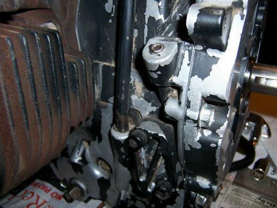

wheelhorseman 3,256 #8 Posted August 17, 2016 (edited) Ok the way to tell for sure if you have a series 2 engine is if it has the oil filter blank on it (the 2 lower Allen head bolts holding the cover on next to the oil dipstick tube on the rear cylinder) this allows you to add a oil filter kit to the tractor and the top or silver Allen head plug is to add a oil pressure gauge (if desired) Edited August 17, 2016 by wheelhorseman1000 2 Share this post Link to post Share on other sites

Kegler 68 #10 Posted August 19, 2016 Thanks Wheelhorse-man1000. . Like oldredrider I was looking for an oil filter and finding none I questioned whether mine was a Series ll. My next question is why build a motor with a pressurized oil system and then not put a filter on it? Doesn't make a lot of sense to me. If mine is a real series ll, I may be more inclined to rebuild it rather than looking for a clone to put on it. Paul in Indiana (70 mi N of Indy) 1 Share this post Link to post Share on other sites
