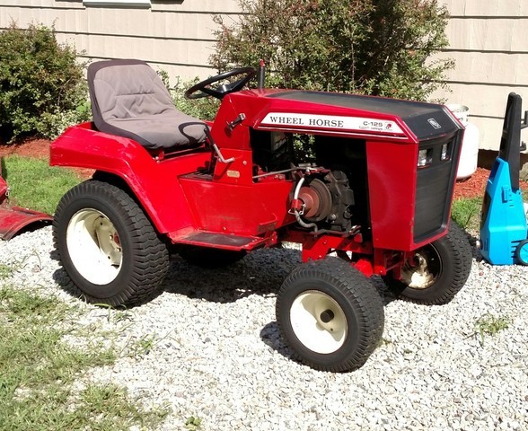

Timbrlnd101 26 #1 Posted August 15, 2016 Hello all, New to site, tractors, and home owning all together. Wife and I just bought first house, on an acre and I picked up a C-125 to start maintenance on the property. It had been sitting a while so after warming it up, I changed the oil, cleaned filter (till I get new one), and new plug. De-greased and power washed body and wheels only. Familiarizing myself with removing deck and front PTO. Came with snow plow as well. My intentions are to slowly restore cosmetics, but only after making sure engine and other functioning parts are maintained. Suggestions for things to clean, check, replace, all that good stuff are welcome as I don't want to screw something up that's not broken, nor do I want to neglect something major before I start to actually use this beast. Thanks all, Looking forward to future convo's Rob PS. My apologies if this is posted incorrectly or to wrong area.. 11 Share this post Link to post Share on other sites

Ed Kennell 46,241 #3 Posted August 15, 2016 (edited) Nice C-125.... and in the correct place with . to I would check the oil in the tranny..If it looks and smells clean with no sign of water ( foam), leave it alone. A shot of grease in the 5 zerks. I would add a fuel filter, then add a treatment of SEA FOAM to the fuel to clean out the fuel system. But if there is gunk in the system and the sea foam loosens it up, it may require a carb cleaning if it clogs a jet. I would also pull the PTO bell and clean and grease the neddle bearing. Edited August 15, 2016 by Ed Kennell 5 Share this post Link to post Share on other sites
wrightorchid 261 #4 Posted August 15, 2016 Looks very clean. I would check/replace the fuel lines (often have a date shown) for cracks/ gunk in the tank, fuel filters, air filters, any electrical connections that might be brittle or corroded. Also, any leaks around the engine, tranny or axles. Go to the files section and download the info on the tractor and engine, and attachments. 2 Share this post Link to post Share on other sites

N3PUY 1,031 #7 Posted August 15, 2016 1 hour ago, Ed Kennell said: A shot of grease in the 5 zerks. Ed, I think there are "6" grease fittings. The axle pivot or the steering gear are sometimes overlooked. 2 Share this post Link to post Share on other sites

Ed Kennell 46,241 #12 Posted August 15, 2016 4 hours ago, N3PUY said: Ed, I think there are "6" grease fittings. The axle pivot or the steering gear are sometimes overlooked. Actually I missed the clutch pedal. I have too many hydros. 3 Share this post Link to post Share on other sites

Timbrlnd101 26 #17 Posted August 15, 2016 Thanks a bunch everyone. I've got this weekend to myself, wife has to travel for work, so I am glad to have a list to start with for the tractor. That would be to complete AFTER her list... of course . Ill make sure run a search for the manual and then have at it! Is the fitting for the grease gun standard? I think I have one lying around... Rob 1 Share this post Link to post Share on other sites
jdleach 525 #18 Posted August 15, 2016 Welcome to the forum. As has already been said, gobs of friendly, helpful folks here. Yes, the zerks are for your standard grease gun. Wheel Horse recommends using a #2 lithium grease. Apply one two or three pumps to each front wheel, steering spindles, front axle pivot, and steering shaft bearing at bottom of shaft where the gear and sector are. Your mower deck will have three fittings, one for each blade at the top of the deck. Apply four or five pumps to each zerk. The general rule, is to apply sufficient grease so that the old grease is forced from the bearing/pivot. Wipe off excess grease. Unless you want a furry blob to build up after a few mowings. 1 Share this post Link to post Share on other sites

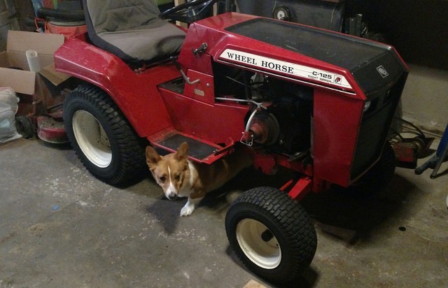

Timbrlnd101 26 #19 Posted August 16, 2016 Quick ground clearance check... Yeah were good... 6 Share this post Link to post Share on other sites
