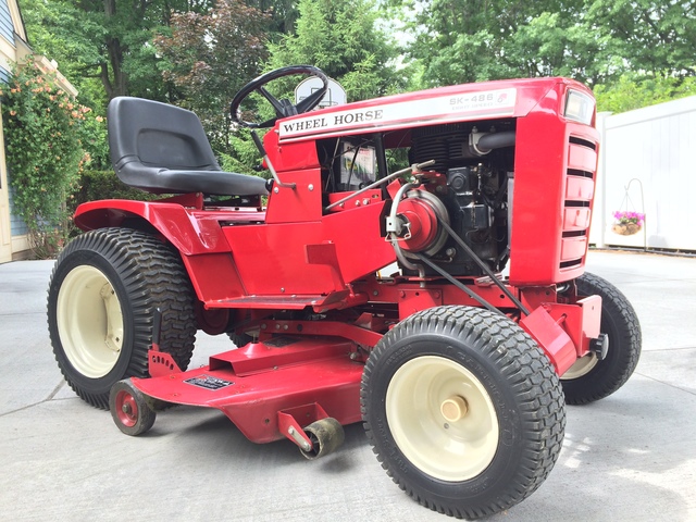

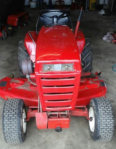

Dan Hankins 80 #1 Posted August 14, 2016 (edited) Pretty happy just picked up a sk-486 Friday. It's in pretty good shape, just needs a few cosmetic things. Any info you guys could share on one would be greatly appreciated. Edited August 15, 2016 by Dan Hankins 11 Share this post Link to post Share on other sites
russellmc301 601 #2 Posted August 14, 2016 well i can tell you one thing, it is a good lookin horse and it looks ready to work. 2 Share this post Link to post Share on other sites
stevasaurus 23,840 #3 Posted August 14, 2016 That SK-486 is a great horse. I think we have a manual for it in the Manual section if you do not have one. Welcome to Red square I especially like the suction attachment that allows the horse to stick on a wall. That is a great storage option. 6 Share this post Link to post Share on other sites

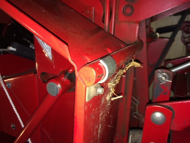

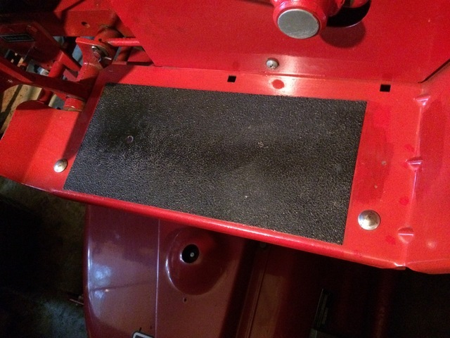

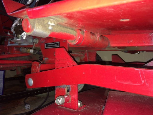

Dan Hankins 80 #17 Posted August 16, 2016 AL c could you get a couple pics under your foot boards, mine looks like it had bolts in the outer holes but there's nothing there to bolt to. I think I'm missing some pieces to hold the floor boards tight. Share this post Link to post Share on other sites
gwest_ca-(File Mod) 12,483 #18 Posted August 16, 2016 9 hours ago, Dan Hankins said: AL c could you get a couple pics under your foot boards, mine looks like it had bolts in the outer holes but there's nothing there to bolt to. I think I'm missing some pieces to hold the floor boards tight. Look at the 3rd Sheet Metal and Covers page of the TIPL The Frame page shows the round bars the footrest bolts to. Garry Share this post Link to post Share on other sites
Al C. 1,474 #19 Posted August 16, 2016 Dan, There are two "clasps" bolted to the underside of the outside of each foot board. The clasps fit around the two rods that extend from the frame. See pics. Good luck! Al C. 2 Share this post Link to post Share on other sites

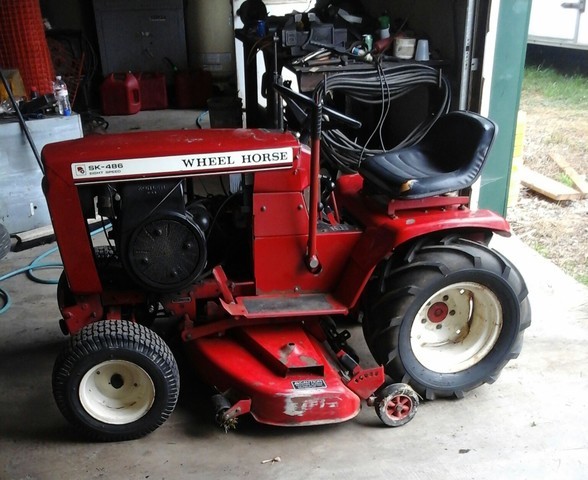

Racinbob 13,134 #20 Posted August 16, 2016 @Al C. I just noticed that your motor is mounted on a plate. With the things that Wheel Horse did over the years I'm wondering if they were using up some motors intended for the short lived shaker mounts. Share this post Link to post Share on other sites
Al C. 1,474 #21 Posted August 16, 2016 Not sure. It's a Kohler 16hp K341. Share this post Link to post Share on other sites
Racinbob 13,134 #22 Posted August 16, 2016 It is something that just hit me. Normally the 10-16 hp k-series are bolted directly to the frame. A couple years earlier when they used the shaker mount it required a different oil pan to fit. It also reduced the oil capacity from 2 quarts to 1 1/2 quarts (if my memory is serving me properly). I can't tell for sure if Dans motor is mounted the same way. Share this post Link to post Share on other sites
