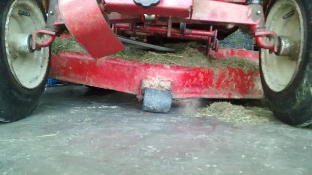

scotty 252 #1 Posted August 12, 2016 I have a deck on my 416h and it will only lift the right side. It will only pick up the left side very little Here is a picture of it 1 Share this post Link to post Share on other sites
russellmc301 601 #2 Posted August 12, 2016 looks like somthing broke have you hit any objects lately? take a look at the lift system and see it anything looks odd Share this post Link to post Share on other sites
scotty 252 #3 Posted August 12, 2016 I haven't owned the tractor very long. The deck isn't in very good shape though. All the lift parts on the deck look straight. It almost looks to me like something is detached but i cant see anything that throws a red flag when watching it lift up and go down. 1 Share this post Link to post Share on other sites
russellmc301 601 #4 Posted August 12, 2016 might be a mount broke off some of the more educated rs members might know i hit a hole one time and mine did the same thing and i toke it off and fix a mount that rusted off. 1 Share this post Link to post Share on other sites
cleat 9,385 #5 Posted August 12, 2016 Looks like the tach-a-matic has come unhooked on the left side (as sitting in the seat). Make sure it is latched in properly. 3 Share this post Link to post Share on other sites
N3PUY 1,031 #6 Posted August 12, 2016 (edited) It's not latched into the mid-mount. And the deck needs slid to the right in the mid-mount. Edited August 12, 2016 by N3PUY 1 Share this post Link to post Share on other sites
scotty 252 #7 Posted August 13, 2016 I will check the mid mount tomorrow. Now that you mention it. It does not look like its latched in correctly. 1 Share this post Link to post Share on other sites
scotty 252 #8 Posted August 13, 2016 Ok i figured it out. It was not latched in quite right. And also the chain that hooks to the lift bar was in the wrong hole. Lifts right up on both sides now. First wheel horse deck ive had this problem with. Share this post Link to post Share on other sites
