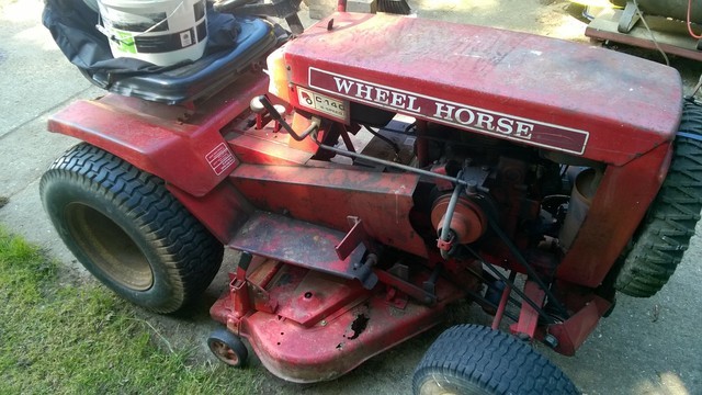

Uncle Nige 2 #1 Posted August 8, 2016 Guys, I have the above wheel horse but now have a gear box transmission issue which I cannot fix, any ideas where any spares are available in Uk else will sell for spare parts Kohler engine runs fine albeit with no air filter as carb needs a bit of work done on it. Any help would be appreciated I am not a fitter just a tinkerer. Regards Uncle Nige 2 Share this post Link to post Share on other sites
Racinbob 12,996 #2 Posted August 8, 2016 Give us more information as to what the transmission is doing. You'd be amazed how simple they are and I'm thinking we could talk you through the fix. 1 Share this post Link to post Share on other sites

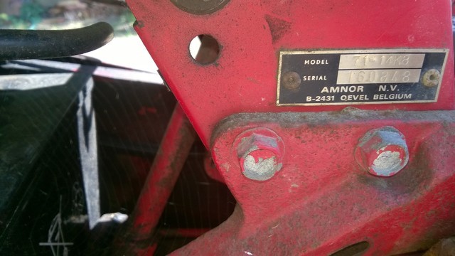

Anglo Traction 761 #3 Posted August 8, 2016 Hi Uncle Nige, Your pretty close to me and I pass through Cuckfield regularly (when they are not digging up the High Street). Have you had the Tractor long, or just obtained it with the problems?. As Racinbob says, an idea of your Tranny problem would help. Carb issues can be easily addressed. At first glance, I thought someone had hacked the Belt Drive Cover, but remembered it must be the Additional Cover for a Tiller Drive !...rare over here. Tractor look's to be about 1975, can you post the Model number of the Black plate please?. Share this post Link to post Share on other sites
Uncle Nige 2 #4 Posted August 10, 2016 Bear with me. Could not select any gear and checked the clutch operation but seemed ok I would assume that the gear selector had become detached but did not feel like it!! This machine I inherited a 2nd hand and has been round the block but did do what was required lugging stuff around the cricket club in Cuckfield. I have a colleague who appered to know a lot about motorbikes so he started taking at apart! Dangerous stuff whell bearings collapsed and as the gear box was prised apart we coud not see what the problem was. Even more difficult it would go back together as springs and balls appeared a over the place. got all the bits but not necessarily in the right order!! Share this post Link to post Share on other sites
