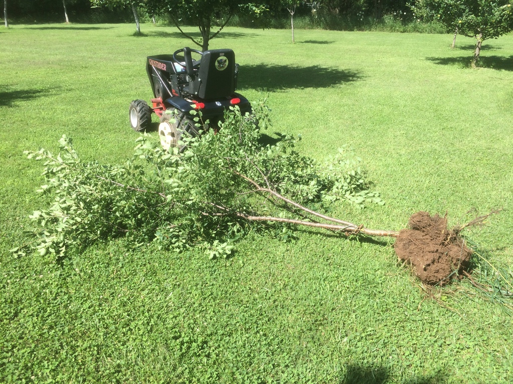

PeacemakerJack 11,039 #28 Posted July 24, 2017 Used the lugging power of GhostRider to pull something besides a plow today! I have a small half acre woods growing on my property. I located a couple of small trees that I didn't recognize growing there last year. When I showed them to my dad, he said "get that junk out of there!". I didn't find out until this year that it is buckthorn, a very invasive species of shrub tree here in central WI. I did some reading and they said not to cut it off because it will get worse, you want to pull it up from the roots. What's better than a weighted plow tractor??? i hooked it up to a chain in and put it in low low and it came right out! I should've taken a video but the mosquitos were so thick, I just wanted to pull it and get outta there! 6 Share this post Link to post Share on other sites
Achto 32,476 #29 Posted July 24, 2017 Looks like Ghost Rider handled that with no problem. It's good that your getting rid of that stuff, It can turn into a real mess in a hurry. Grows & spreads faster than box elder. 3 Share this post Link to post Share on other sites

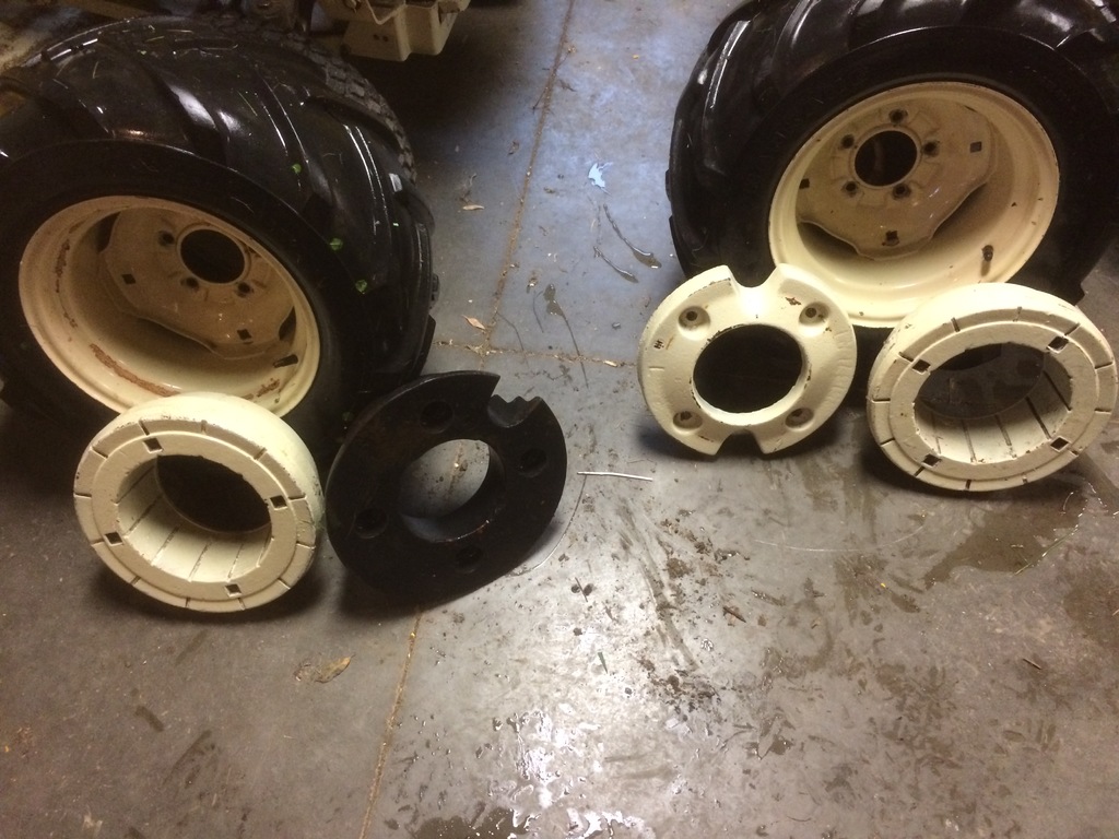

PeacemakerJack 11,039 #33 Posted July 30, 2017 Good eye Aldon! Actually, because of the lean angle into the furrow (right side), the land side rear tire gets a little lighter. Typically, most guys will add more weight to the land side wheel. I have a set of WH weights on the inside of both of my rims, that gives me a little more than 50# per side, then on the land side I have a late model toro weight and an IH Farmal/Cub weight. That gives me another 75-80lbs on the land side wheel. I feel it gives a good amount of balanced traction to the rear wheels. Also, you don't want anything to stick too far out of your furrow wheel--because it will hit the furrow wall and cause problems. The only thing I don't care for with my current setup is that it has a very tight clearance between the inside of the tire and the fenderwell. That only causes an issue when the ground is wet and sticky---then it likes to ball up, collect there and cause plug ups. A different back set on the rim would correct the problem. I may change them someday if it poses too much of an issue for me... 4 Share this post Link to post Share on other sites

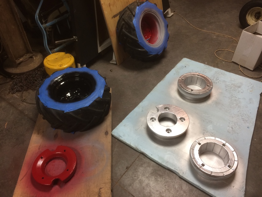

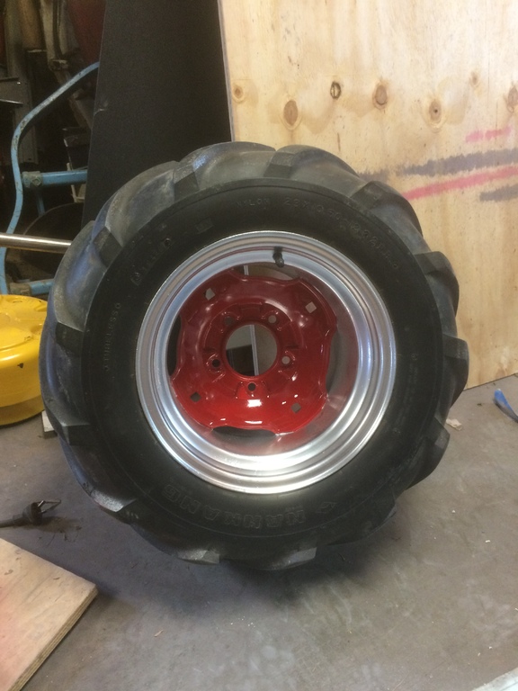

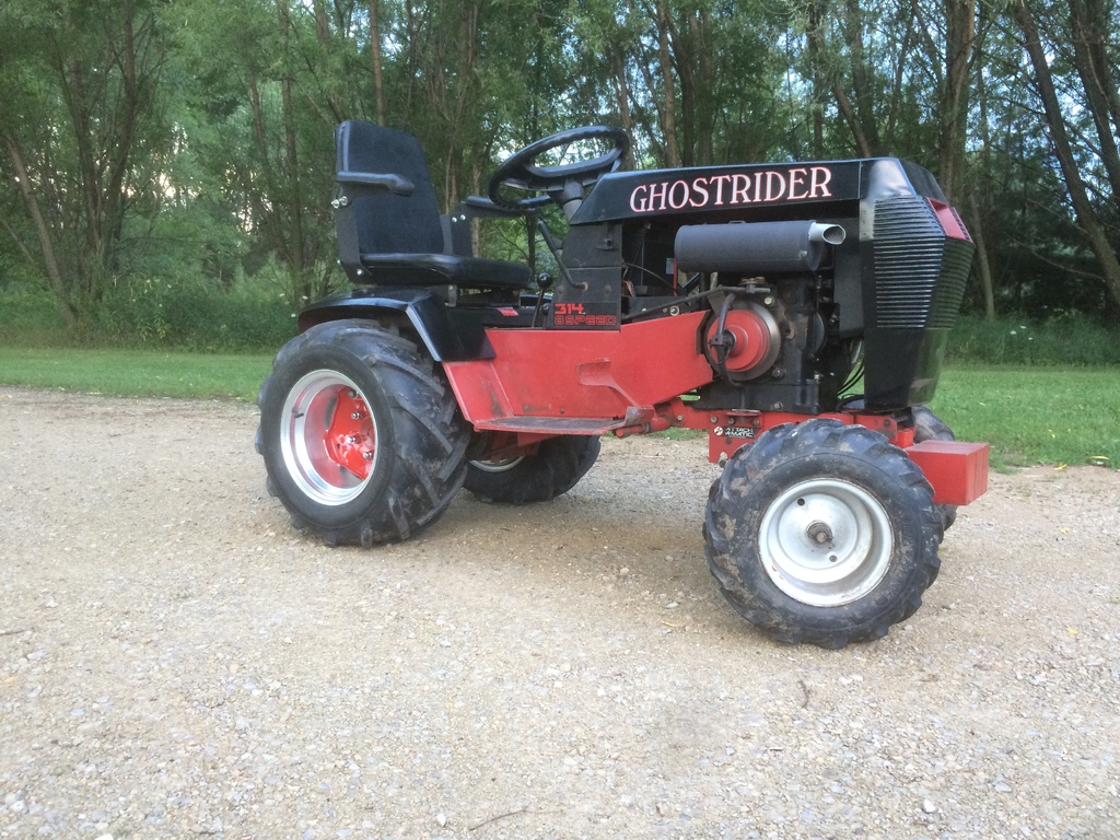

PeacemakerJack 11,039 #34 Posted August 5, 2017 Finally got the rear wheels and weights repainted... This is what I have on GhostRider for weights-- A set of WH weights, a Toro weight that came with my Dxi, and a Farmall Cub weight. I was tired of the cream not matching the black, red, and silver theme. So I went to work... I used Rustoleum Aluminum for the weights and the rim portion of the wheel. Since this is a dedicated plow tractor, I decided to paint the centers of the wheels red. It took quite a bit more work but I like the results. Just a few more items to finish and my plow rig will be complete! This is a really fun tractor! 9 1 Share this post Link to post Share on other sites
Aldon 4,832 #35 Posted August 5, 2017 I really really like the aluminum paint with red insert. Gonna borrow that:-) 1 Share this post Link to post Share on other sites

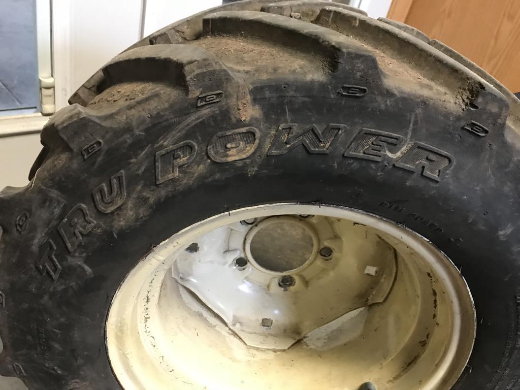

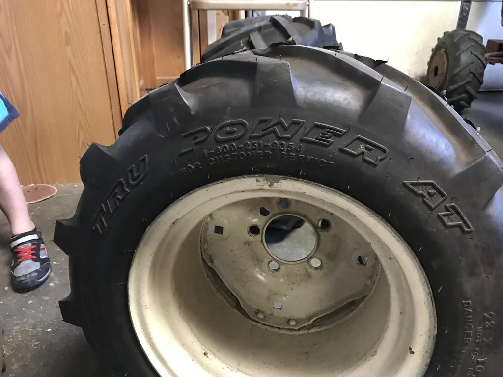

PeacemakerJack 11,039 #50 Posted July 11, 2018 (edited) Things that are different are not the same... While at the BS I bought a set of AG’s on custom rims from @Aldon. The setback is similar to a WH setback. The rims pictured above are Cub rims and the setback pushes the tires too close to the inner fenders for my liking... The interesting thing is that both tires are Carlisle Tru Powers. Both are sized at 23-10.50-15 and yet look at the difference. This one is from Aldon and is listed as a AT. My existing tire just says “Tru Power”. Regardless, I’m very pleased with the look of the finished product, hopefully it will function as good as it looks in the field! Zach got to drive it around the yard for the first time and was lovin’ It! I like the extra clearance to the inner fenders if the plowing gets laden with bean stubble or a little muck my fenders should stay much cleaner. I’ve been at several Big fall plow days where I had to fish out all the debris packed in the furrow wheel fenderwell because the clearance was just too close. Not anymore! Edited July 11, 2018 by PeacemakerJack 1 3 Share this post Link to post Share on other sites
