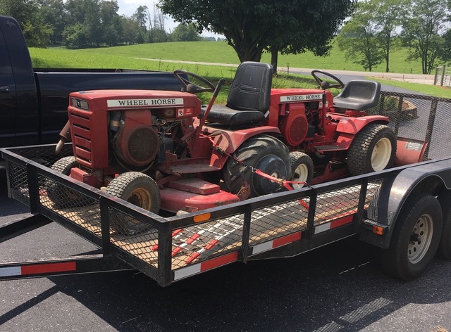

tywilk02 28 #1 Posted August 8, 2016 First the 1973 no name 12 hp 8 speed. Tractor has set for years it was stored with the tank and carb emptied of any fuel. Battery of course is dead, so I just hooked some jumper cables off another mower to it. When I turn the key it does nothing, no click, nothing. I have 13.2 volts on the + side of the coil, I have continuity through the pto safety switch, i have 12.8 v on the middle post of the solenoid. I've pecked the solenoid with a hammer, I've filed the points and set the gap at .020". I've attempted to jump it from the starter and it just cranks and cranks, pulled the plug, no spark, changed plug and plug wire out with one from a running tractor still no spark. Coil is warm to the touch after a few minutes. I'm not sure what I'm missing the next step is to start swapping parts. On to the c-160 battery is shot jumped it started and was running fine until I remove the - jumper cable. It died immediately. Reconnected jumper cable and started it right back up this time I removed the + cable and it ran for 5-8 seconds and then died. Could a dead battery with a bad cell be causing this or do I have a magneto problem? Share this post Link to post Share on other sites

pfrederi 21,346 #13 Posted August 8, 2016 It is the magnets that can be damaged. Incidentally from your picture your C-160 does not have a magneto...It has battery ignition 1 Share this post Link to post Share on other sites
tywilk02 28 #14 Posted August 8, 2016 9 minutes ago, pfrederi said: It is the magnets that can be damaged. Incidentally from your picture your C-160 does not have a magneto...It has battery ignition How does a person tell what ignition it has just by looking at it? Were all C-160s like that? Share this post Link to post Share on other sites
pfrederi 21,346 #15 Posted August 8, 2016 You have the beer can coil mounted on the front of the blower housing. Kohler used 3 different systems Magneto with breaker (has points but no visible coil. Breakerless (has no points but a triangular shaped coil mount on the blower housing)battery ignition had points and the beer can coil. 2 Share this post Link to post Share on other sites
