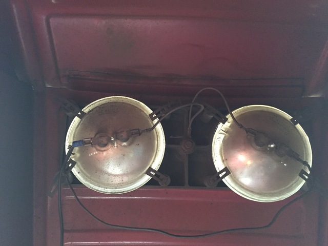

SylvanLakeWH 32,008 #3 Posted August 7, 2016 Thanks for the reply. No ground wire attached to the hinge bolts or engine. Only one I see is on the headlight mounting plate shown in picture. The lights worked great with this configuration until today. Wiring diagram does not appear to show a ground like you describe. Should there be one? Or should I add one? Share this post Link to post Share on other sites

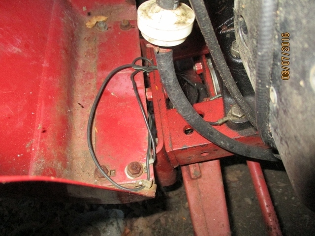

N3PUY 1,031 #7 Posted August 7, 2016 I looked at 7 Wheel Horses and only one of them has a hood ground wire. (and that one doesn't even have lights). Here's a pic of the one that does. Hood hinge bolt to motor mount. 1 Share this post Link to post Share on other sites

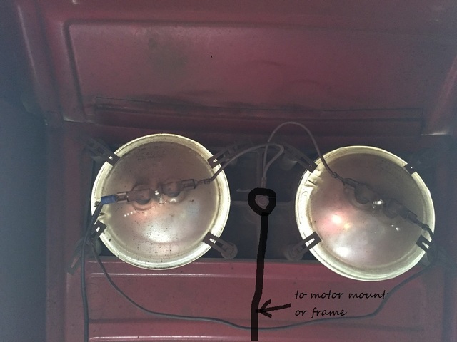

N3PUY 1,031 #8 Posted August 7, 2016 ground wire from the stud between the lights to the frame or motor mount. 1 Share this post Link to post Share on other sites
