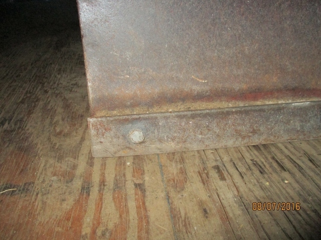

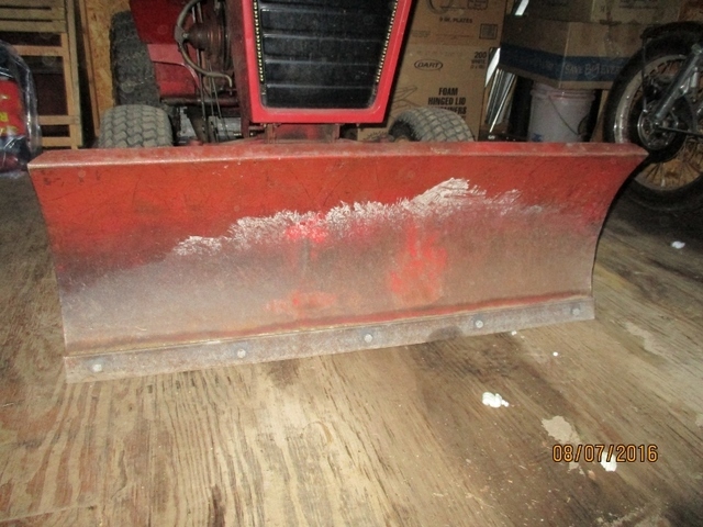

KC9KAS 4,746 #4 Posted August 7, 2016 I made my own... 5 Share this post Link to post Share on other sites
N3PUY 1,031 #5 Posted August 7, 2016 The fab shop stocks flat stock in various widths (1", 1½", 2" etc) and just cuts the length you request. They don't cut it out of a full sheet. And don't charge for cutting. I wish I had a square drill bit! 1 Share this post Link to post Share on other sites
857 horse 2,588 #6 Posted August 7, 2016 At first...i thought it was a thread file....Is that real???? makes a square hole ???? Im 60 and never seen this before?? 1 Share this post Link to post Share on other sites
Bach-Ed 170 #7 Posted August 7, 2016 That "square file" is a broach. Machine shops use them to make odd shape holes and square is the most common shape. They can be pulled or pushed through a round hole to create the desired hole. A decent machine shop will know all about these and probably have the right one on hand. 1 Share this post Link to post Share on other sites
