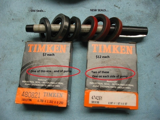

daveoman1966 3,883 #3 Posted August 7, 2016 Here are replacement PUMP seals...TIMKEN... 2 Share this post Link to post Share on other sites
