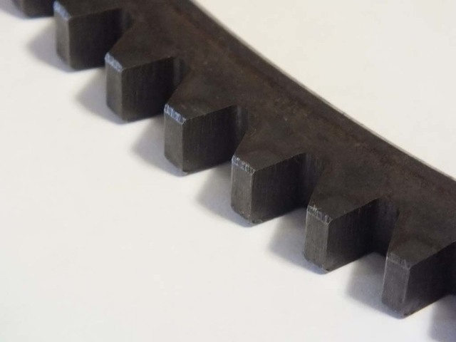

onanparts.com 185 #8 Posted August 12, 2016 On 8/8/2016 at 6:29 PM, davedean said: thanks guys for the info. I would love to compare the old starter with the new, but the old starter is not OEM. The previous owner removed one of the starter mounting bolts, the bolt closest to the engine, and wedged a piece of wood between the starter and the frame forcing the starter teeth closer to the flywheel. so if there is no adjustment then it must be the ring gear that is bad. I did a quick look at the teeth on the flywheel and did notice there is some wear. I sure hope that's the problem. Thanks Onanparts.com for the part #. Keep in mind one side, facing the starter, the teeth are beveled. The side facing away from the starter the teeth are not beveled. Important when swapping in a new one! Damaged teeth the area will typically be shiny and uneven. Share this post Link to post Share on other sites

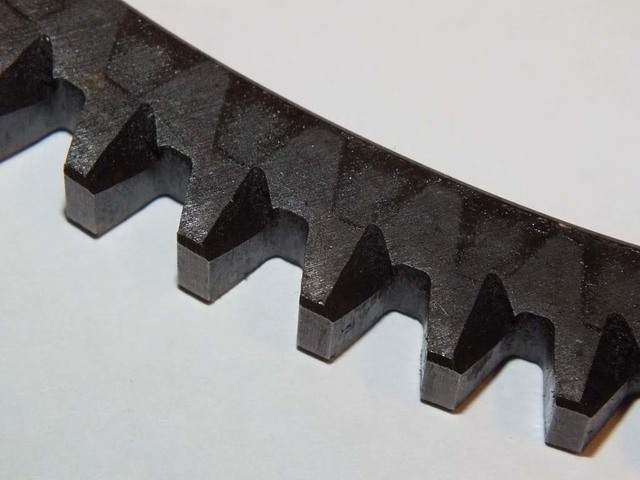

onanparts.com 185 #10 Posted August 22, 2016 This is what a new ring gear looks like, or one in good condition. Beveled side faces the starter. Non beveled side facing the cooling fins. If your ring gear looks like this one then it's fine. Can you post up some pics of yours? Share this post Link to post Share on other sites
davedean 2 #11 Posted August 22, 2016 On 7/23/2016 at 6:38 PM, davedean said: If it doesn't work can I return it? On 7/23/2016 at 5:57 PM, Shuboxlover said: I have a great used one.... $55 shipped to your door, let me know is you'd like to proceed. Best regards, Tyson I can tell you the teeth look nothing like the one you showed me. I'll try to send you a pic Share this post Link to post Share on other sites
onanparts.com 185 #12 Posted August 22, 2016 On 8/20/2016 at 1:42 PM, davedean said: Thanks onanparts the ring gear is toast I got the flywheel off and the teeth are all beveled or ground down on the inside at about 45 degrees. That must be the problem, but the starter teeth are a little chewed up as well, 3 questions please: #1 Is that starter gear replaceable, I mean is it available? #2 How does one remove/ replace the flywheel gear, there are no bolts holes, so I assume it is a press connection, if so does it require heat to remove/replace? #3 does the teeth on the flywheel gear have to line up with anything on the flywheel, like timing gears have to? Thanks for your advice, Dave #1 yes & yes. #2 This vid is close enough to getting it right, although I prefer thick leather welding gloves when installing the HOT new ring gear on the flywheel. The guy in the vid just grabbed it with some rags. Note in the vid do NOT get it cherry red or even a little red. It just needs to be hot and it will drop right on the flywheel. Make sure the beveled side is installed so it will face the starter. Nothing to line up like timing gears, just don't get it on backwards. Share this post Link to post Share on other sites

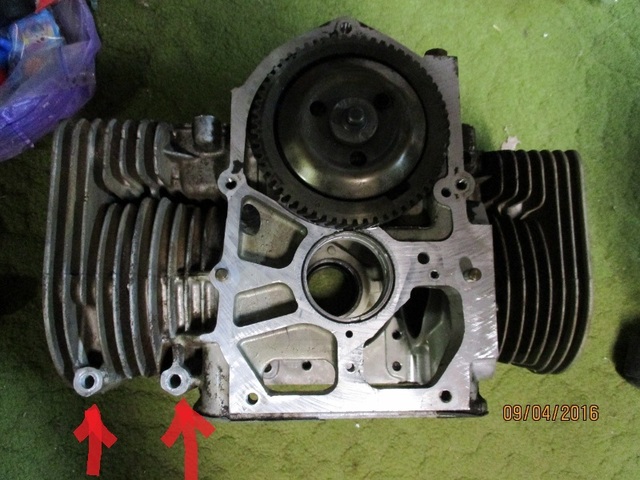

davedean 2 #14 Posted September 3, 2016 Back on the starter/ ring gear. This one has me baffled! Onan P220G-I New OEM starter #191-1949-04 New OEM ring gear #104-0779 The gears barely mesh. Just enough to grind the tips of the teeth. What is wrong here?? I was told (and I find no) adjustments on this setup I'm at a total loss. Any suggestions ideas please? Share this post Link to post Share on other sites
boomers_influence 106 #15 Posted September 4, 2016 dave i would look at the starter mounting lugs on the bottom of the # 1 cylinder. when they are damaged the starter will not engage properly. thank you. boomer ( the used onan engine parts guy, also NOS and new ) Share this post Link to post Share on other sites
davedean 2 #16 Posted September 4, 2016 Thanks a million boomers_ The lug closest to the center of the engine is damaged. I noticed this when I removed the old starter, not thinking much about it. I kinda repaired it with JB Weld. Is there any fix short of replacing the jug? Share this post Link to post Share on other sites
N3PUY 1,031 #17 Posted September 5, 2016 I think the starter mount holes are part of the block. Share this post Link to post Share on other sites
davedean 2 #18 Posted September 5, 2016 (edited) uh oh looks like I'm screwed. I guess I'm gonna have to jerry rig something. Thanks for the pic, it says everything. The lug on the inside is bad Edited September 5, 2016 by davedean add info Share this post Link to post Share on other sites

boomers_influence 106 #20 Posted September 5, 2016 dave a oil pan from a B 43E, B 43G, or B 48G, along with the correct inertial style of starter is what you. need. thank you. boomer Share this post Link to post Share on other sites

davedean 2 #22 Posted September 7, 2016 Thanks boomers, I'll give it a look, but the starter is patched in and seems to be doing ok for now. Share this post Link to post Share on other sites
