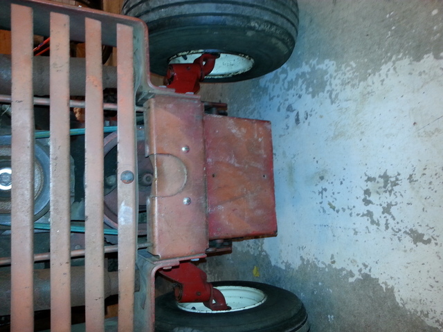

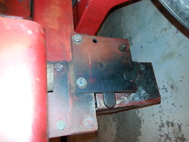

BMW1 44 #3 Posted August 5, 2016 Thank You. Here are pictures of the front and the side. Isn't this the attach-o-matic setup? Share this post Link to post Share on other sites
pfrederi 19,945 #4 Posted August 5, 2016 The frame rails (and hence the tachmatic) are farther apart on a D than on a regular horse. Share this post Link to post Share on other sites
BenTheWheelHorseMan 43 #5 Posted August 6, 2016 I knew that there was some reason that it wouldn't work, I just couldn't remember. @pfrederi you hit the nail on the head with that answer. Share this post Link to post Share on other sites
