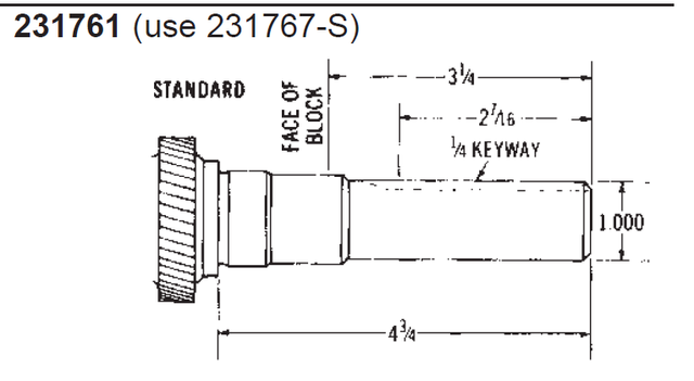

scotty 252 #1 Posted August 2, 2016 (edited) I have a question. I am wondering what the shaft length is on the k 181? Im thinking about replacing it with a honda. or maybe a honda clone? It keeps losing spark every few weeks. Edited August 2, 2016 by scotty Share this post Link to post Share on other sites

scotty 252 #3 Posted August 2, 2016 Just what i was looking for thank you! Share this post Link to post Share on other sites
