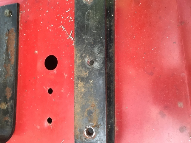

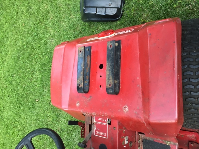

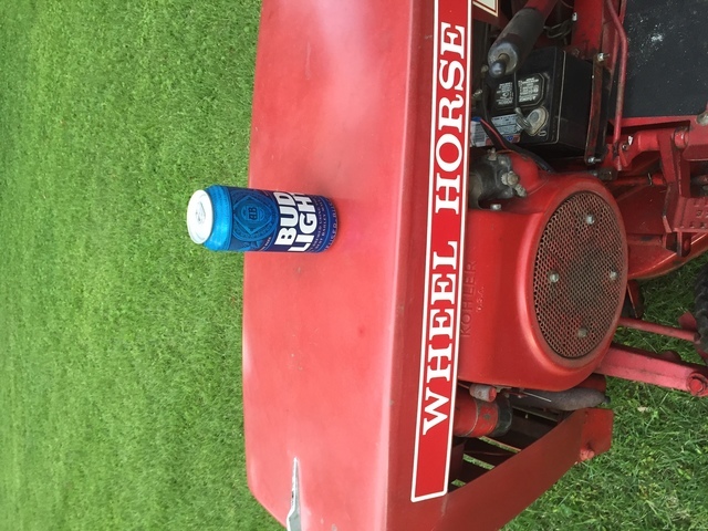

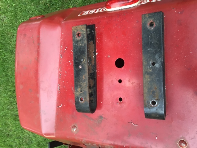

vmen84 61 #1 Posted August 2, 2016 (edited) I think I fixed my Issue with mobility and the seat my father-in-law Took the seat off and drilled two holes further back then we reset the seat. I still have an issue putting my legs over the transmission area but I figured out that while while I'm on the seat if I take my right hand and place it underneath the fender on the right side and rotate my legs completely over the steering wheel and drop them down on each side that's going to be the easiest way although I look like I'm doing something for the Olympics it works I'll just have to get used to it here are some pictures of the modified seat . I also forgot to mention that I also have to place the mower deck lever all the way forward to do this. Edited August 2, 2016 by vmen84 10 Share this post Link to post Share on other sites
312Hydro 474 #2 Posted August 2, 2016 Great solution. I had a seat for my 312h that the holes would not line up. I just redriled like you did and it worked out ok. Funny how a little thirst quencher makes the job so satisfying when it's done. 6 Share this post Link to post Share on other sites
Wheel-N-It 2,978 #3 Posted August 2, 2016 You've got a good father inlaw to drill those two holes. Does he have a drill press? I drilled the spring steel mounts on a 312 without the help of a drill press and boy I had one heck of a time drilling through those two pieces of steel. And of course it was about 100 degrees while I was doing it, so that made the whole thing that much more painful. LOL 4 Share this post Link to post Share on other sites

953 nut 66,503 #9 Posted August 2, 2016 9 hours ago, T-Mo said: Drilling into the seats springs is no easy task as that is hardened stee If you heat a small point where you want to drill the hole and let it cool you reduce the hardness and make drilling much easier. 2 Share this post Link to post Share on other sites
