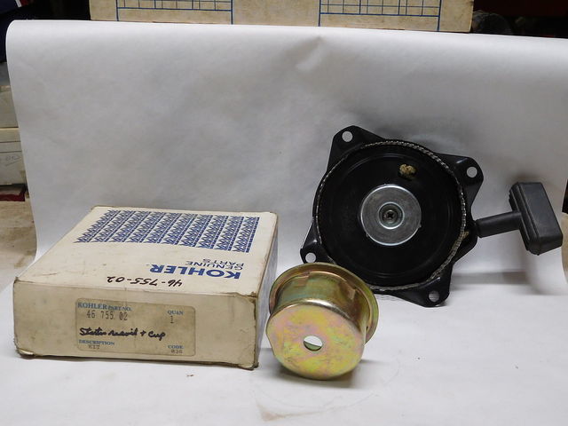

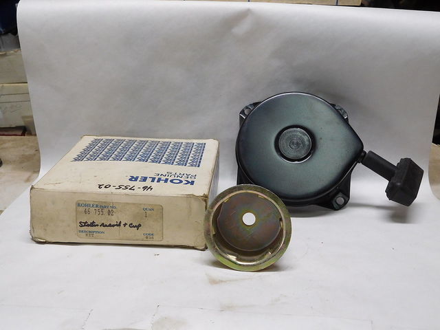

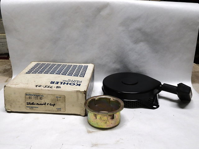

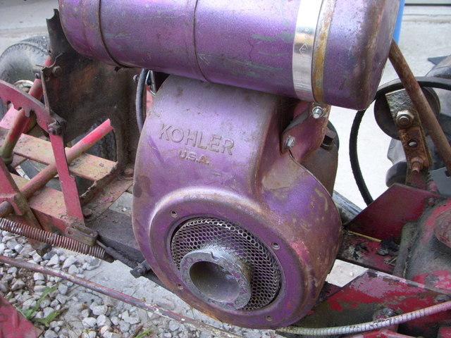

T-Mo-(Moderator) 5,002 #1 Posted August 1, 2016 I found this starter, Kohler 46-755-02. I believe it will fit my K-91, but want to be sure. As you can see, I have the rope starter pulley on my K-91. I'm assuming I just remove the current pulley and install the cup shown with the starter? Is this starter complete? I never dealt with retractable starters before, other than pulling on them with my push mower and weed eater, etc. Share this post Link to post Share on other sites
clueless 3,440 #2 Posted August 1, 2016 Thats the one. Should bolt right up, the grass screen looks like the right one. They usually come with the four mounting screws. Chris 2 Share this post Link to post Share on other sites
T-Mo-(Moderator) 5,002 #3 Posted August 2, 2016 I'm going to need this starter quicker than I thought as the current one has issues now. One of the areas behind the rope notches broke leaving only one notch for the rope. But then the center piece where the bolt comes through completely broke. The cast aluminum isn't holding up well. Share this post Link to post Share on other sites
