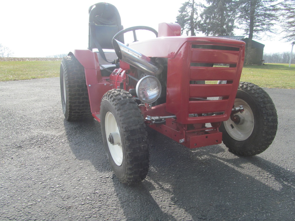

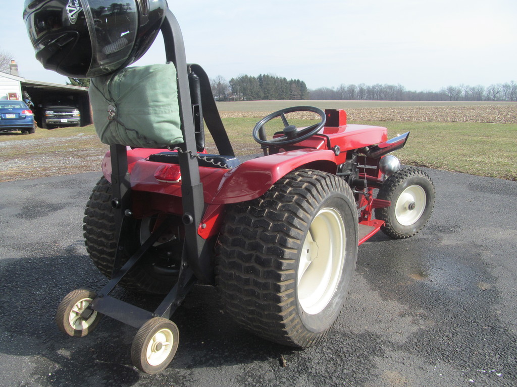

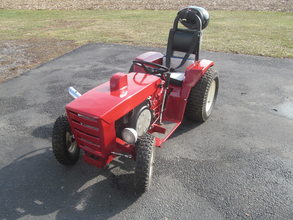

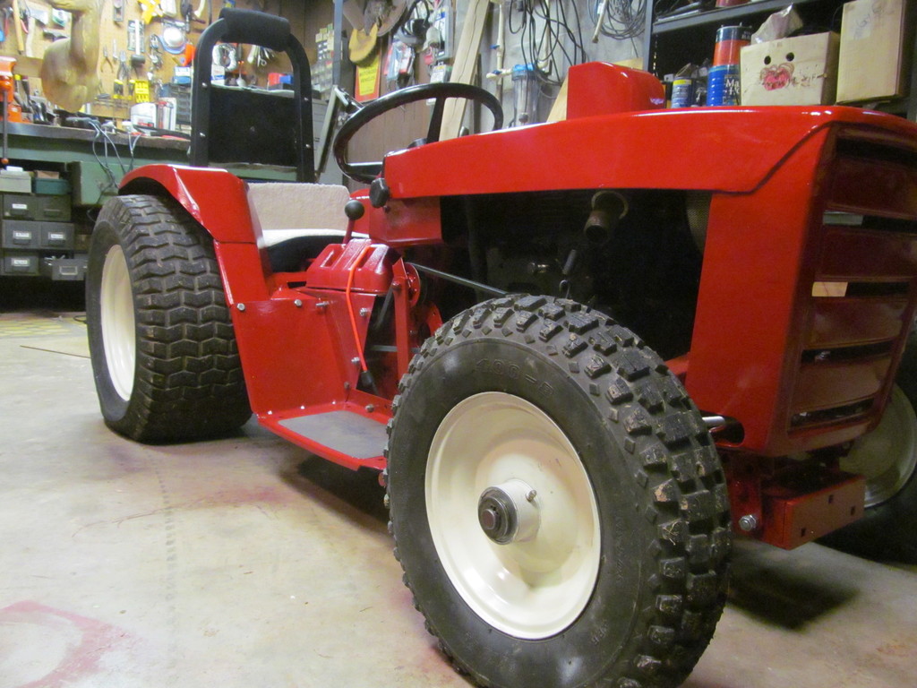

Ed Kennell 47,817 #56 Posted January 16, 2017 Time for an up date.....It's getting close to finished. Still undecided on the decals. Maybe a CRAZY HORSE? 17 Share this post Link to post Share on other sites
JAinVA 4,638 #57 Posted January 16, 2017 Ed, I can't believe I just found this thread.That is an amazing creation.Looks like you put a lot of thought and effort into it. 3 Share this post Link to post Share on other sites
elcamino/wheelhorse 9,363 #58 Posted January 16, 2017 If I don't see anything else at the Big Show , I have to see the "Low Rider" . Ed you do amazing work. 4 Share this post Link to post Share on other sites
clemet 146 #59 Posted January 17, 2017 Looks sweet. Wish I had the parts around to do something similar. 1 Share this post Link to post Share on other sites
19richie66 17,950 #60 Posted January 17, 2017 That looks great Ed. The hood turned out sweet! Nice ride. 1 Share this post Link to post Share on other sites
AMC RULES 37,260 #61 Posted January 17, 2017 AWESOME Ed... ...can almost hear...born to be wild blaring in the background. 7 Share this post Link to post Share on other sites

lynnmor 9,073 #64 Posted January 17, 2017 I think that a short racing style windshield would be a nice touch. 2 Share this post Link to post Share on other sites

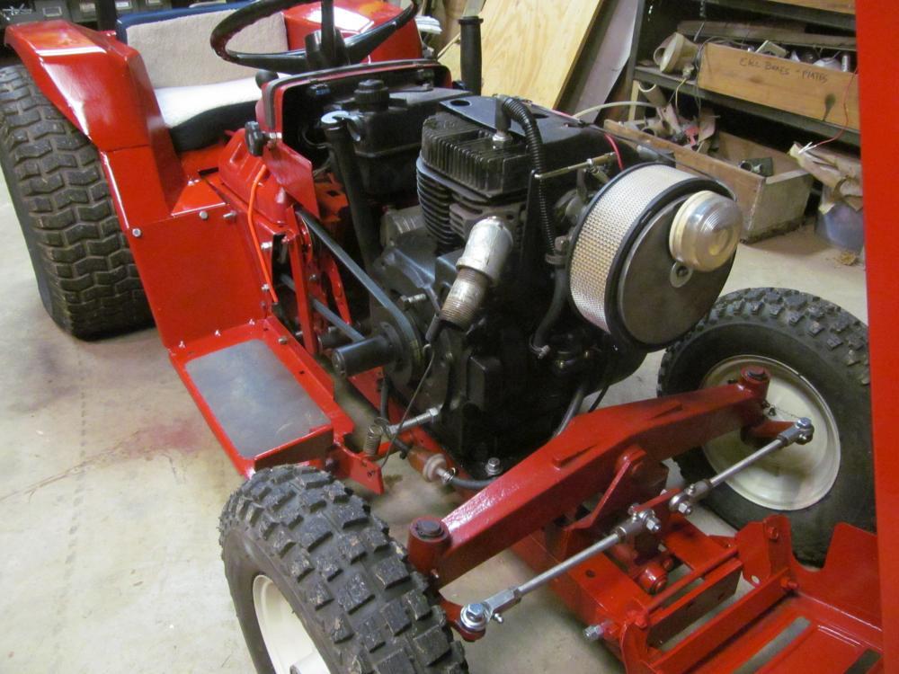

Jaymon74 84 #65 Posted January 18, 2017 On 8/23/2016 at 6:00 PM, Ed Kennell said: Got all the major parts pretty much in position. Got the front axle and steering figured out. Still need to get an engine and build a clutch. How much drop does a frame flip give ya? 2 Share this post Link to post Share on other sites
Ed Kennell 47,817 #66 Posted January 18, 2017 Flipping the frame lowers it about 6", but I also cut out the center of the flipped frame and added another frame below the two ends. This lowered the engine about 9" total. The height of the engine dictated the height of the hood, hood stand, and floor boards. The spark plug actually protrudes thru the hood into the air vent. 3 Share this post Link to post Share on other sites

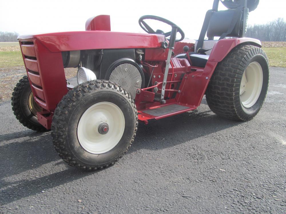

Ed Kennell 47,817 #68 Posted February 7, 2017 Wow, 70 F here today, so I was able to work outside. 9 1 Share this post Link to post Share on other sites
