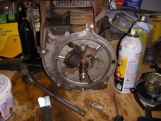

wallfish 20,744 #5 Posted July 31, 2016 Yes, there should be a condenser. Pull the flywheel and post a pic. Share this post Link to post Share on other sites
T-Mo-(Moderator) 5,005 #6 Posted August 2, 2016 Point gap checks out okay, so it's time to pulled the flywheel. Share this post Link to post Share on other sites

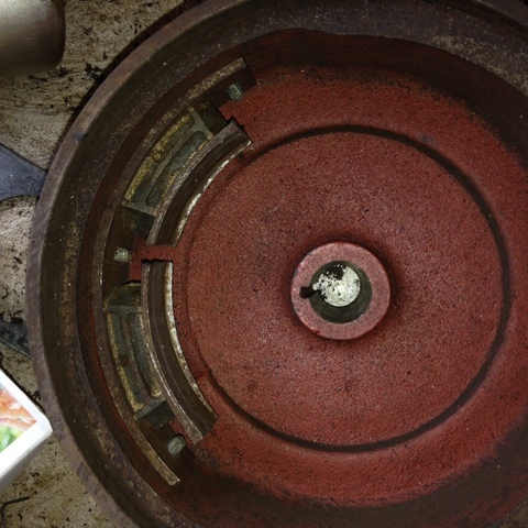

T-Mo-(Moderator) 5,005 #12 Posted August 15, 2016 More troubleshooting. I read in the Kohler service manual that to test the flywheel magnets, you can hold a screw driver blade about an inch from the magnet and if they magnet is good, it will quickly draw the blade to it. One of the magnets on my flywheel will draw the screw driver blade around half an inch or so, maybe more. But the other one it's more like under a quarter of an inch. That one looks like it's got some wear on it as it's tapered a bit on one side. Looking in Parts Tree to see if these can be bought, they're not shown in the flywheel or the ignition section that I can see. If these can be bought, does anyone have one that they're willing to sell? I can post a wanted to buy ad if necessary. I have the coil and condensor on order from ebay. Share this post Link to post Share on other sites

wallfish 20,744 #15 Posted August 15, 2016 (edited) I got one, edited my post but somehow it didn't stick. Seems much easier and cheaper to send just the magnets instead of the whole flywheel. It's only held on with 3 screws so make sure yours can be removed without any broken screws. Send me a PM with your address and I'll ship it first so you can test it out. If that's not your problem you can just send it back. Edited August 15, 2016 by wallfish 1 Share this post Link to post Share on other sites
