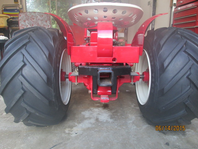

clueless 3,437 #8 Posted July 31, 2016 13 minutes ago, AMC RULES said: Ordered one from Tom two days ago, he said he was going to fab a few up in the next couple of weeks. Good guy, and a great price. 1 Share this post Link to post Share on other sites
857 horse 2,588 #10 Posted July 31, 2016 Built like a safe,,,,,,,One good investment.....the tractor will break before the hitch goes anywhere....... This should have been a factory option or accessory.. Tom is a very nice guy................I have 2 of these ......worth GOLD !!!!! 4 Share this post Link to post Share on other sites
roadapples 6,987 #11 Posted July 31, 2016 That is one nice looking rear.....I know I`m old.. 1 Share this post Link to post Share on other sites
