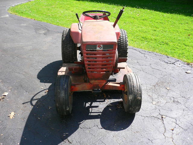

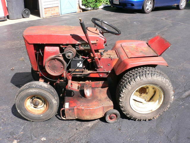

wfrpalm 218 #1 Posted July 30, 2016 I took my 875 for the first ride of the year today, it started right up and ran good for the first couple of minutes but then lost power and seemed like it was running out of gas, I started to smell gas and when I looked at the sediment bowl it was shooting a stream of gasoline from the the hole that usually has the shut off valve in it. I would like to know if I should do away with the bowl, replace it or see if I can get a new valve ( or find the one that fell out ). 2 Share this post Link to post Share on other sites
