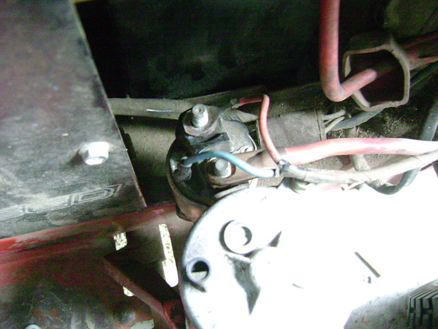

dsyharrydsy 0 #1 Posted July 30, 2016 is this the correct wiring 87 wheel horse Share this post Link to post Share on other sites

N3PUY 1,031 #4 Posted July 30, 2016 (edited) The small red wire goes on the same terminal as the cable from the battery. That looks like an Onan starter ..... the battery cable goes on top where the small red wire is. Edited July 30, 2016 by N3PUY 1 Share this post Link to post Share on other sites
953 nut 69,560 #5 Posted July 30, 2016 As shown in the photo you appear to be connecting the battery directly to the started; bypassing the solenoid. If you attached the "+" to the battery it would crank the starter continuously. Like N3PUY said, both go to the top, the lower terminal is directly to the starter. Share this post Link to post Share on other sites
