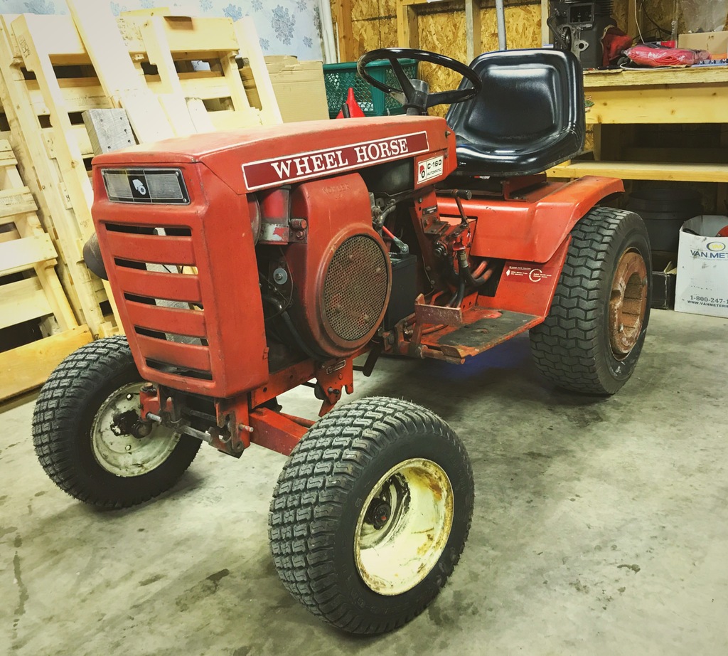

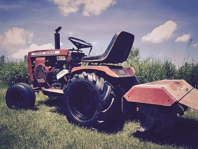

Midwestfoodplot 7 #1 Posted July 30, 2016 I have a 74' C-160 automatic. Kohler K341s Cast Iron 16 hp that I've used for about 4 years now for tilling only. This past week, it wants to die when the brake is released and the drive belt is engaged. The safety switches have never been Hooked up since I got it.Absolutely no power. idles pretty good when brake is on. New Parts Installed: Battery Coil,plug and wire Ignition Switch Regulator Cables ( all wiring connections went through) fuel pump, Fuel filter,carb cleaned condenser and points stator Any help or recommendations would be great! Thanks in advance 1 Share this post Link to post Share on other sites

953 nut 70,295 #3 Posted July 30, 2016 nice looking , I presume that your engine is equipped with an electronic ignition system rather than a points and coil system. If this is the case, remove the black wire from the ignition module (it has one function which is to short out the coil to ground),and start the engine, engage the drive, if it doesn't die out the problem is a black wire in the safety system being pinched by the linkage. Hope this helps, let us know. Share this post Link to post Share on other sites
benji756 342 #4 Posted July 31, 2016 good looking tractor I like the ags and stack on it Share this post Link to post Share on other sites

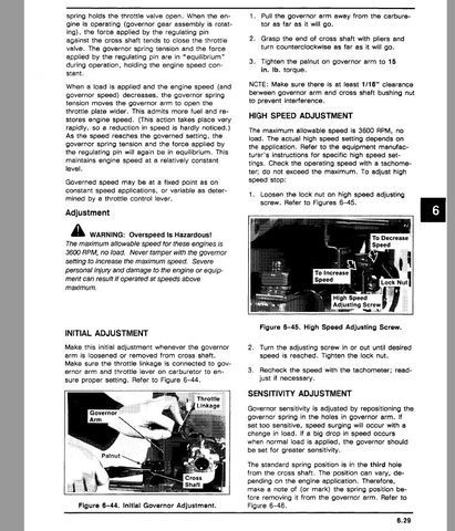

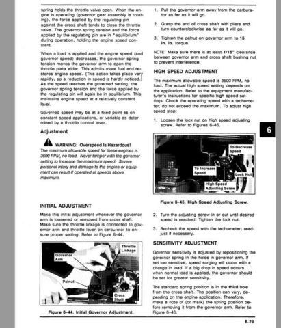

pfrederi 21,296 #6 Posted July 31, 2016 Compression tests are not valid because of the automatic compression release. You have to do a leakdown test. Also check your governor. The arm may have slipped on the governor shaft. 1 Share this post Link to post Share on other sites
Midwestfoodplot 7 #7 Posted July 31, 2016 I did a compression test and it came out at 110 to 115. Seems like a good number. Adjusted govenor shaft counter clockwise, it stopped after 1/16 of a turn so I tightened to arm back down. I put more tension on the spring for more sensitivity. It still wants to die when brake is released. Tried adjusting some things on the carb and that didn't help. Engine sounds like it is idling too high still. Share this post Link to post Share on other sites

Midwestfoodplot 7 #23 Posted May 2, 2017 3 hours ago, pfrederi said: Any good machine shop can look up the STD .010 .020 and .030 for any Kohler engine. I would take the block to them let them tell you what you need 10/20 or 30 I'll do that for sure. Thank you. 38 minutes ago, Searcher60 said: If it's now got an oversized piston, the oversized will be stamped in the piston top. Maybe covered with carbon. If it has not been bored, STD will be stamped in the piston top. I am rebuilding my C-160 now, due to rattling noise. My bore is fine. Crank needed to be turned. Lower balance gear bearing failed on mine. . My C-160 Hydro tow release was stuck also. Just a very little heat, and light tapping and mine came loose. Counterclockwise for towing. Where re did you get that muffler? Thanks I couldn't find a stamp on the top after I cleaned it up good, I'll have to look again though. I'll also try freeing up the tow valve when I get a chance. For the muffler, I used the stock down pipe, cut the muffler off and flipped it upright and welded a stack on it. I wrapped the "up pipe" in fiberglass exhaust wrap and put hose clamps on either end to hold it down. Share this post Link to post Share on other sites
