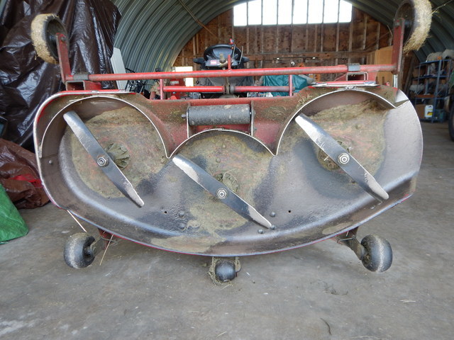

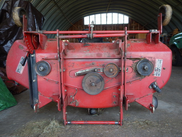

stumplifter 11 #1 Posted July 28, 2016 Hi, first time poster, found this forum whilst trying to wade through the quagmire of spare parts identification. Hope that someone (anyone) can help. Here is the run down: I have a Toro tractor it has a nameplate with the following information on it: Model 73542 SN 200000204 The mower deck does NOT have any nameplate information on it, but it should be model 78357 – 44” cut (the part numbers referenced below are from the manual). I am not the original owner, I do not know the original owner, this was purchased from a tractor auction facility. It has 3 blades that when measured from tip to tip is 46” not 44”. The blades are 16” (16 1/8” diagonal) and have a ¾” mounting hole – the replacement blades #54-0010 in the manual are 15 1/2" have a 5/8” mounting hole. It was also recognized that the v-belts also have a length difference (95-4094 = 97” existing belt is 102” and 95-4228 = 82” existing belt is 98”). My other concern and I don’t have actual Toro dimensions, is that one of the spindle housings (88-4510) is cracked. The dimensions of the damaged spindle housing is 4 1/8” over all height, with a 2” diameter, 11/16” high shoulder that sticks through the deck. The mounting bolt circle is approximately 3.2”. From pictures that I have seen on line the spindle housing 88-4510 is squatter and has a larger mounting bolt circle. I also just noted that the spring loaded idler assembly in the manual looks greatly different than the one pictured below. I have attached a few pictures, and to the untrained eye the deck certainly looks like 78357, but I am puzzled by the discrepancies – I desperately need to know what I have so I can order the proper replacement parts while my grass is growing higher than my house. Share this post Link to post Share on other sites
gwest_ca-(File Mod) 12,511 #2 Posted July 28, 2016 I think you have a 48" deck Garry 4 Share this post Link to post Share on other sites
stumplifter 11 #3 Posted July 28, 2016 You sir, are rather awesome! Can't thank you enough, it sure looks like it. Doing my happy dance! 1 Share this post Link to post Share on other sites
gwest_ca-(File Mod) 12,511 #4 Posted July 29, 2016 Here is the operator manual This deck was supplied 1998-2005. Garry 2 Share this post Link to post Share on other sites
