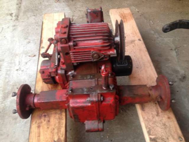

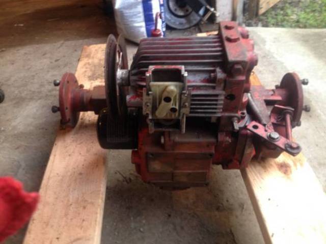

BobbyD218 7 #6 Posted July 27, 2016 Good question.....The seller didn't say if it is an Eaton or Sundstrand; only that it came off a C tractor. The pump looks very similar to the Eaton that is in my Bolens. Here are the two pics from the ad. What do you think???? Share this post Link to post Share on other sites
oldredrider 2,553 #7 Posted July 27, 2016 Definitely a Sundstrand. 1 Share this post Link to post Share on other sites
BobbyD218 7 #8 Posted July 27, 2016 "The 1980 C-175 used a Sundstrand in the early models (oil filter faces the right side with an S in the model number) and an Eaton 1100 in the late models (filter faces the rear with an E in the model number)" I found this in an earlier post on this subject. From the operator's seat, the oil filter would be facing the right. So if this is true, than I suppose this rear end has a Sundstrand pump. Thanks OldRed... I assume a complete rear end swap isn't in the cards... Share this post Link to post Share on other sites
953 nut 66,672 #9 Posted July 27, 2016 None of the linkage from your Eaton will line up with that Sundstrand unit. Glad you posted the pictures, the seller is misinformed. Share this post Link to post Share on other sites
953 nut 66,672 #10 Posted July 27, 2016 None of the linkage from your Eaton will line up with that Sundstrand unit. Glad you posted the pictures, the seller is misinformed. Share this post Link to post Share on other sites
pfrederi 20,678 #11 Posted July 27, 2016 Sudstrand Piston to piston with brake. Putting on your 312 would require a lot of work/fabrication Share this post Link to post Share on other sites
