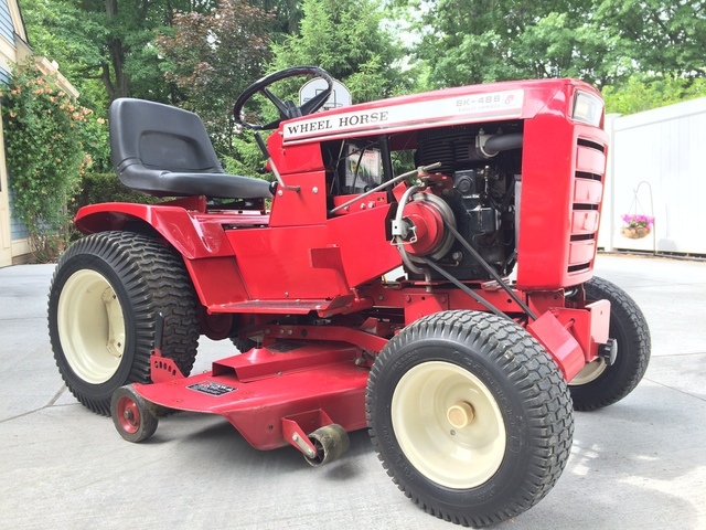

Al C. 1,474 #1 Posted July 26, 2016 The Kohler K341 engine (1982, 16hp) on my Wheel Horse SK-486 is knocking. The engine has 1300 hours, does not smoke, has great power, and starts on the first crank. It has made the knocking sound for as long as I have owned it (one year). I have cleaned the cylinder head, replaced the head gasket, cleaned the fins, put in a new spark plug, replaced the points (0.018 gap) and condenser, changed the oil, replaced the air cleaner, and tuned the hi/low carburetor mixture at 1200 and max RPM. The sound has not changed. The knocking disappears completely when I engage the PTO. In fact, even slight pressure on the PTO will cause the sound to stop. I am not an engine expert, but I am concerned that there is "play" somewhere in the engine that is not good. So, before something really bad happens I am interested in opinions whether this is normal or whether I need to have the engine looked at. I read about a lot of engines being rebuilt. Does this indicate a rebuild is in order? If so, is this something I can undertake myself with a "rebuild kit"? Otherwise the tractor is like new and I want to keep it that way. Appreciate everyone's input. (Video link and picture attached.) https://www.dropbox.com/s/utp94ukos6oe97z/File Jul 26%2C 2 51 38 PM.mov?dl=0 Share this post Link to post Share on other sites

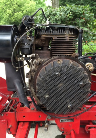

N3PUY 1,031 #2 Posted July 26, 2016 (edited) Sounds like the main bearings on the crank. Too much play side to side. Take off the PTO pulleys and measure the end play of the crankshaft. It is adjustable with the paper shims on the flywheel side. When you engage the PTO it pushes the crank to the flywheel side. Tractor looks too nice to be that noisy. Edited July 26, 2016 by N3PUY 3 Share this post Link to post Share on other sites
rmaynard 17,442 #3 Posted July 26, 2016 is exactly what I was thinking The more shims that are placed between the bearing plate and the crankcase, the more end play. 2 Share this post Link to post Share on other sites
Al C. 1,474 #4 Posted July 26, 2016 I'll give it a try tomorrow. Just curious, the adjustment you are referring to, can I do this myself? Does the engine need to be removed from the chassis? Share this post Link to post Share on other sites
N3PUY 1,031 #5 Posted July 26, 2016 You can probably do it yourself. It can be done on the tractor. I think in a Kohler engine manual there is the spec for the end play. Share this post Link to post Share on other sites
WHX?? 57,470 #6 Posted July 26, 2016 No engine should not have to leave the frame. You will need to remove some tins and pull the flywheel. Before you do this do check the end play like the guys suggested and while you have the pto off check the bearings in it as well. Should have the end play specs in the manual here. its a nice looking tractor Share this post Link to post Share on other sites
Al C. 1,474 #7 Posted July 28, 2016 (edited) So here is the final chapter of the story. I'll title it, "Amateur Falls on Sword". I took the pto pulley off and prepared to remove the flywheel. Then I tested for the end play on the crank shaft. There isn't any!! I tried everything I could to move the shaft. Hit it with a rubber mallet, pryed it with a crow bar - nothing. After all that, I was concerned I might have damaged something, so I started it up. Turned over on the first crank as usual, but there was no knocking. Convinced that I had done something that inadvertently fixed the problem, I put things back together. Started it up - knock is back. You guessed it, there is rythmic vibration in the mechanism that operates the PTO. I could shoot myself. All this effort, and the source is the simplest thing. So, I want to apologize for consuming your guys' time. But also want to thank you for teaching a newbie another aspect of the infamous Kohler engine. Edited July 29, 2016 by Al C. Typo 3 Share this post Link to post Share on other sites
