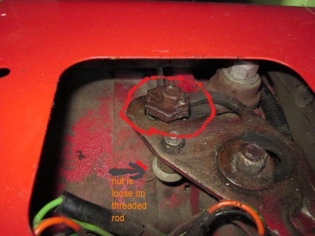

Detector 72 #6 Posted July 27, 2016 Ok I'm lacking on forward speed and also it will creep "reverse" at times even after brake is applied to return it to neutral, I think that is due to where the previous owner greased the area and vibration moves the lever, I'm going to degrease this area. This pic is with the motion control fully forward, I'm lacking a bit of forward speed but not much The Eton manual states on neutral adjustment to loosen the lock bolt and turn large eccentric with a wrench.... I'm assuming the lock bolt is the one I have circled. I noticed the motion control rod lock nut has backed off on the threads at the rear, I'm thinking the rod needs adjusted and not the eccentric 1 Share this post Link to post Share on other sites
Detector 72 #7 Posted July 27, 2016 (edited) I removed the shift plate and the jam nut was a bit loose there to, not sure why they were loose? I shortened the rod going by feel and it has picked up a extra mph!! Still having issues with it creeping but not at every press of the brake to return to neutral. I'm going to get the grease off to see if that helps Edited July 27, 2016 by Detector Share this post Link to post Share on other sites
