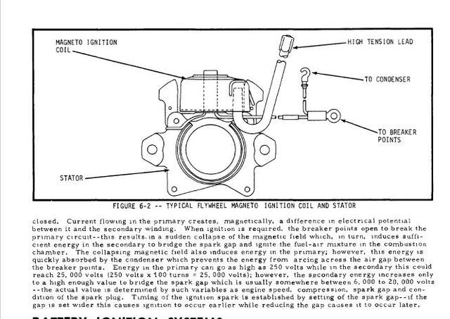

pfrederi 20,234 #4 Posted July 24, 2016 Check the connections for any corrosion. Is that voltage with the engine off or when it is running. I you don't have a battery load tester What does the voltage drop to when it is cranking. On weak spark, what kind of ignition system do you have? Is there a triangular shaped coil bolted to the air shroud or a round coil mounted someplace? 1 Share this post Link to post Share on other sites

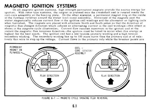

seven 202 #5 Posted July 24, 2016 It drops off to 8 volts when cranking.i don't see any coil the sparkplug wire goes rite into the flywheel Share this post Link to post Share on other sites

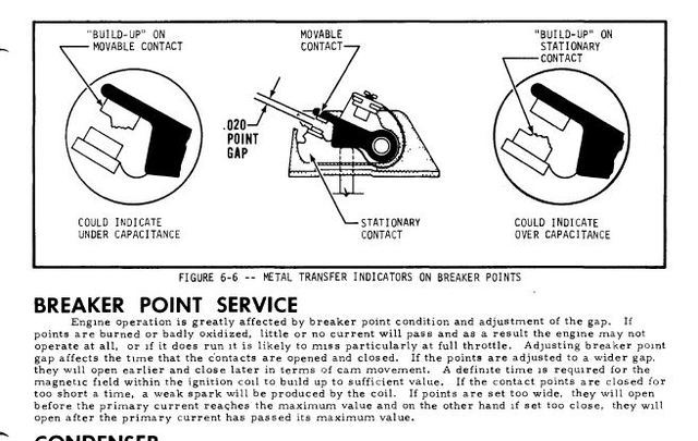

pfrederi 20,234 #6 Posted July 24, 2016 A good battery should hold 9 volts when cranking. Yours sounds weak. From your description you have a magneto ignition system which uses points. Have you check them? 2 Share this post Link to post Share on other sites
seven 202 #7 Posted July 24, 2016 OK thxs I Will get new battery for starters then set points 1 Share this post Link to post Share on other sites
TDF5G 2,073 #8 Posted July 25, 2016 Sounds like poor/corroded connections or weak battery. Share this post Link to post Share on other sites
seven 202 #9 Posted July 25, 2016 New battery did it. Still no spark cleaned points then it started its been sitting in barn to long 3 Share this post Link to post Share on other sites
