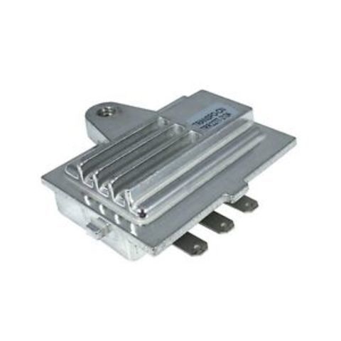

rmaynard 17,409 #3 Posted July 23, 2016 Since they are fairly inexpensive, I would try replacing the voltage regulator. 1 Share this post Link to post Share on other sites
Kurt-NEPA 756 #4 Posted July 23, 2016 I'm thinking you cooked a voltage regulator too. I would replace it and see what happens. It is located on the top of the engine toward the rear and bolted onto the sheet metal shroud. Three connectors. Center has a red wire, rear has two wires (black and gray) and front has a black wire. Shop around for price, they vary widely. Best price I found was on Amazon. 1 Share this post Link to post Share on other sites
squonk 47,276 #5 Posted July 23, 2016 Good chance a cooked reg would not only not charge the bat but discharge it when off. 1 Share this post Link to post Share on other sites

Aussie 98 #10 Posted August 16, 2016 Just an update; I couldn't get a voltage regulator locally so ordered one online. In the meantime I took a used one out of a spare Onan and fitted that. It didn't make any difference, still not charging. I looked at the information from Professor SOI that Digger66 provided the link to above. I checked the voltage at the B+ terminal and it was the same as battery voltage, so all ok there. Then went to start the engine to check the output voltage - wouldn't turn over. The dash lights came on with the key, but in start position they went out and nothing. Gave up and went fishing as suggested by DougC. Late last week the new RR arrived. Yesterday I checked the fuse block, no signs of any overheating or corrosion in the wiring, all looked good but I replaced all three fuses. Then I checked the the 9 pin connector, all looked like new - no overheating or corrosion at all. Next I cleaned the battery terminals and leads and gave them all a dressing with a file. After that I fitted the new RR with an earth lead from the mounting bolt to the frame. Cleaned up the wiring terminals that fit on the RR. Tractor started right up and is charging - hooray! I was going to mow today but the wind has been blowing like mad all day. Not sure what the problem was, although the second RR may have also been fried, I haven't ever run the engine it came off. The first one certainly looked suspect when I removed it, the resin had delaminated from the body. Not sure what caused it to not turn over but suspect it may have been due to a bad earth. Nothing obviously wrong with any of the wiring, the tractor has only done 200 hours and always been kept inside and the harness looks near new. All appears to be okay now, thank you to all who responded, and especially the Professor for his clear, easy to follow diagrams and explanations. Share this post Link to post Share on other sites
