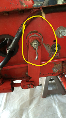

doc724 927 #1 Posted July 22, 2016 I have this C125 Automatic (Eaton 1100) with hydro lift and there is this hook attached to the lift linkage. It is accessible when the side cover is installed. It does not seem like it has any function other than an indicator of whether the cylinder is retracted or extended. It has no connection to any hydraulics and screws into the end of the bell crank. I could not find any reference to it in the owners manual that I downloaded. Can someone enlighten me? 1 Share this post Link to post Share on other sites
cleat 8,988 #2 Posted July 22, 2016 No idea. Likely something that a PO added. Share this post Link to post Share on other sites
squonk 46,895 #3 Posted July 22, 2016 Yes it is an indicator. My C-125 hydro had the same thing. 2 Share this post Link to post Share on other sites
KC9KAS 4,746 #4 Posted July 23, 2016 The junk C-125 I had also had that indicator...It is factory! 1 Share this post Link to post Share on other sites
