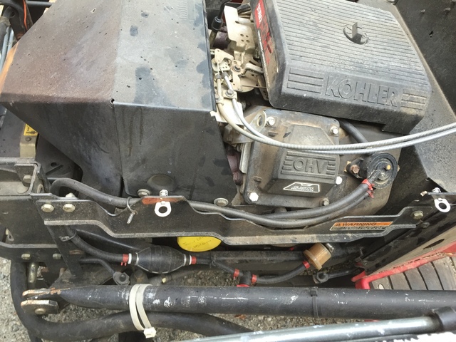

Forest Road 595 #1 Posted July 20, 2016 (edited) I have a 314 h and 522xi loader at the vacation home. They make our property maintenance much easier. What used to be an issue is no more. Stale gas in the carb and dead batteries. After having to clean out a few carbs I chose to take the easy road. These tractors don't see more than 20 hours a year. The gas would often go bad in the carb and leave me with more to do. The easy way around this is to shut off the fuel and let the carb run dry. Starting it up the next time could be an issue. I started by replacing all of the fuel line. Used a simple 1/4 turn inline valve, an inline marine fuel pump, and a fuel filter. Now i I turn the fuel off and let em run dry. When it's time to start a few pumps of the hand pump and they fire right up. No more waiting for the mechanical fuel pumps to pull fuel. Also started using solar chargers on the batteries. Haven't had a dead battery in 5 years. http://m.harborfreight.com/15-watt-solar-battery-charger-68692.html?utm_referrer=direct%2Fnot providedm Edited July 20, 2016 by Forest Road 6 Share this post Link to post Share on other sites
SylvanLakeWH 32,783 #2 Posted July 20, 2016 11 minutes ago, Forest Road said: I started by replacing all of the fuel line. Used a simple 1/4 turn inline valve, an inline marine fuel pump, and a fuel filter. Now i I turn the fuel off and let em run dry. When it's time to start a few pumps of the hand pump and they fire right up. No more waiting for the mechanical fuel pumps to pull fuel. Also started using solar chargers on the batteries. Haven't had a dead battery in 5 years. Great idea! I've used the solar charger on my boat for years - works like a charm! Share this post Link to post Share on other sites
Achto 32,897 #3 Posted July 20, 2016 Awesome ideas!! Only thing extra I would do is add some Sea Foam to you gas. Stabilizes the gas and cleans the system while the engine runs. 2 Share this post Link to post Share on other sites
