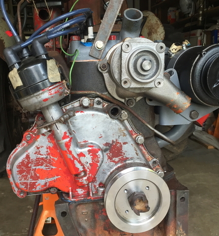

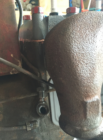

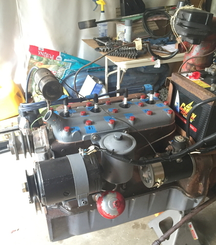

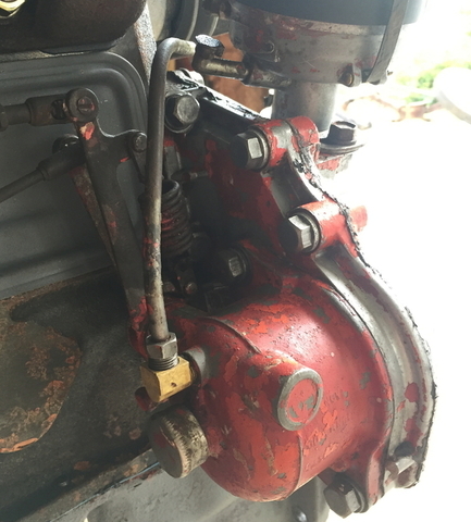

persof 14 #5 Posted July 20, 2016 All, This engine has new: pistons, rings, bearings, valves, ground crankshaft, milled block, milled head, rebuilt oil pump, new gauges, new oil pressure relief spring and lots of other things. I did poor some oil into the pickup while the engine was inverted on my engine stand. I also squirted lots of 30W into the opening at the rear of the engine where one pipe goes to the oil gauge and the other goes to the oil filter as it looks to me like oil is pumped from the front main bearing/oil pump assy through a tube that runs length wise feeding the bearings and then exiting this port. See the photo with the exhaust port. I have included some other photos that you can refer to with reply's. I have spent lots of $ and time on this; this is the last major snag (and its critical) Share this post Link to post Share on other sites

Kurt-NEPA 755 #8 Posted July 20, 2016 (edited) +1 on the NTractorClub.com - Great resource. On your first picture, The open hole just below the water pump is where the oil pressure relief valve resided. Did you replace it? Edited July 20, 2016 by Kurt-NEPA Share this post Link to post Share on other sites
Kurt-NEPA 755 #9 Posted July 20, 2016 On your last picture, the taped hole in the block should go into a tee. One line goes to the oil filter (I think it is the return line) and the other to the oil pressure gauge. You can check for flow by cracking the line to oil pressure gauge. You should get flow with the engine running. I've seen more than one bad oil pressure gauge, so this a quick check. I would post your problem on the NTractorClub.com. Great bunch of guys there that know more about these old N's than I do. Friendly too! BTW. That engine looks great! Nice job! Share this post Link to post Share on other sites
