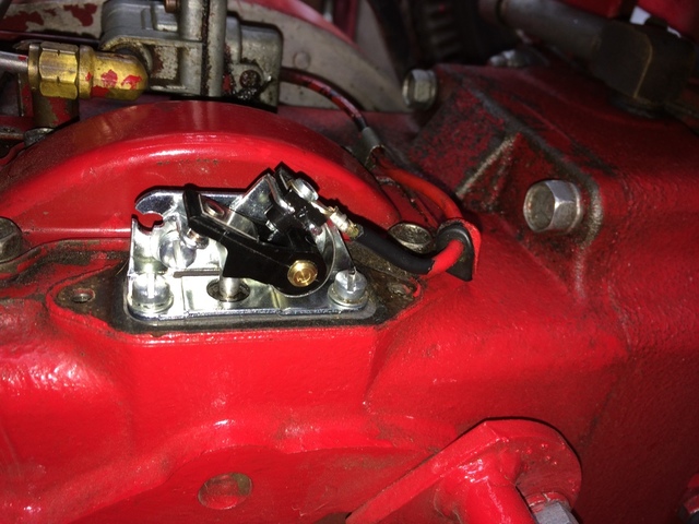

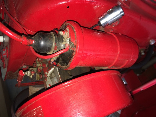

Al C. 1,474 #1 Posted July 18, 2016 I replaced the points and condenser on my 1967 T1067 Wheel Horse, just because they had never been replaced. Wow!!! What a difference. Runs much smoother and at much lower idle speed. More power too. Best $48 I've spent! 4 Share this post Link to post Share on other sites

Ed Kennell 46,240 #6 Posted July 19, 2016 Best to use the timing mark on the flywheel and an ohm meter to set the points. If you use feelers instead, I have found the older Kohlers run better with points gap set 0.002" less than the manual. 4 Share this post Link to post Share on other sites
Wheel-N-It 2,978 #7 Posted July 19, 2016 3 hours ago, Ed Kennell said: Best to use the timing mark on the flywheel and an ohm meter to set the points. If you use feelers instead, I have found the older Kohlers run better with points gap set 0.002" less than the manual. So would that be .018 Ed? Share this post Link to post Share on other sites
Ed Kennell 46,240 #8 Posted July 19, 2016 Right Van, If I can't locate the timing mark, and I have to use feelers, I try to set mine so .017 goes and .019 no goes. 2 Share this post Link to post Share on other sites

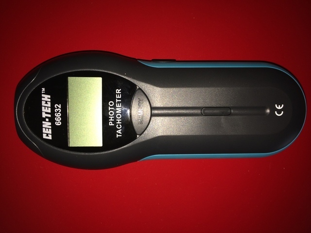

rmaynard 17,233 #20 Posted July 21, 2016 @Al C. you mentioned earlier that it now idles at a much slower speed. Be sure that the idle is not less than 1100 to 1200 RPM or you will not be lubricating the engine properly. 2 Share this post Link to post Share on other sites
Ed Kennell 46,240 #21 Posted July 21, 2016 1 hour ago, Al C. said: Video deleted. It played fine on my PC although it was a very short video. And it did sound like a happy horse. Share this post Link to post Share on other sites
Al C. 1,474 #22 Posted July 21, 2016 Thanks for the note regarding the idle speed. How can I measure RPM's? Share this post Link to post Share on other sites
rmaynard 17,233 #23 Posted July 21, 2016 I sprung for a little infrared tachometer. A whopping $8.95 on Amazon. Now that was several years ago, and they have gone up in price, but they are still available at reasonable prices from many sources. Search this forum for "measuring engine speed" for more interesting stuff. Share this post Link to post Share on other sites

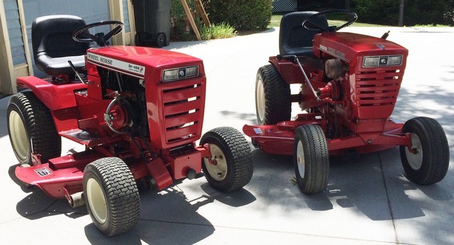

Al C. 1,474 #24 Posted July 21, 2016 (edited) I went over to Harbor Freight. They have an infrared photo tachometer for $39.99. It's a good bit more than Bob paid at Amazon, but it was worth the value of walking home with it. Both of my machines were idling high. I tuned them to 1200RPM idle. Wow, what a difference. It's like they whisper. I've attached a picture of the tach meter and the newly tuned fleet. Thanks everyone for the help. It's always a pleasure doing a project with my Wheel Horse buddies. Edited July 21, 2016 by Al C. Typo 5 Share this post Link to post Share on other sites
