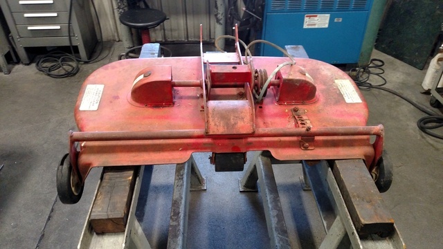

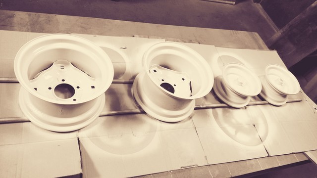

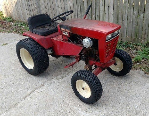

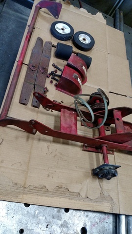

TIGman 2,006 #1 Posted July 17, 2016 Well the 875 wheel painting is done all set to have tires mounted. Moved on to the mower deck. Actually the deck is in pretty good shape, just the wheel/roller axles need replacing. 3 Share this post Link to post Share on other sites
953 nut 68,867 #2 Posted July 17, 2016 Great working with a nice deck that hasn't been beaten up. Also, love those heavy duty saw Horses! 2 Share this post Link to post Share on other sites

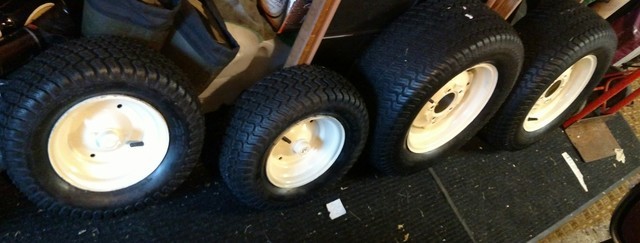

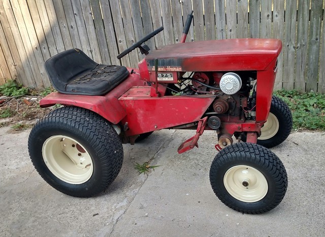

TIGman 2,006 #3 Posted July 19, 2016 On 7/17/2016 at 6:26 AM, 953 nut said: Great working with a nice deck that hasn't been beaten up. Also, love those heavy duty saw Horses! Yes ,that deck is not in bad shape at all.Can't wait to get that one going again. Yep those saw horses are definitely Heavy Duty. I have some BIG jobs setting on them while I weld. On 7/16/2016 at 9:47 PM, TIGman said: Well the 875 wheel painting is done all set to have tires mounted. Moved on to the mower deck. Actually the deck is in pretty good shape, just the wheel/roller axles need replacing. After work I mounted up the tires on the rims. The 875 will no longer be a static display on jack stands. Hope to mount wheels on the 875 tomorrow. 4 Share this post Link to post Share on other sites

TIGman 2,006 #5 Posted July 20, 2016 Well the 875 got her wheels put back on tonight and moved out from behind the Horse Barn ready for her time in the spot light. I'm going to try and not get distracted by any other tractors that come up for sale..... Notice I said try......lol 8 Share this post Link to post Share on other sites
PeacemakerJack 11,039 #6 Posted July 20, 2016 Looking great! You can bet I'll keep a close eye on this thread with one of my favorite tractors of all time! 1 Share this post Link to post Share on other sites

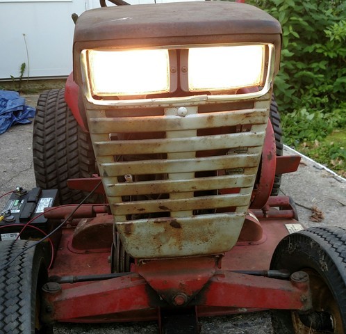

19richie66 17,932 #7 Posted July 20, 2016 Whats up with the headlights? Someone cut out the hood or have I just not had enough coffee yet to see clearly? Looks neat. 1 Share this post Link to post Share on other sites
TIGman 2,006 #8 Posted July 20, 2016 1 hour ago, 19richie66 said: Whats up with the headlights? Someone cut out the hood or have I just not had enough coffee yet to see clearly? Looks neat. Yes someone had cut out hood and added lights. The vote from everyone on "keep them, they make it look mean" . I like them too and they work!! 3 Share this post Link to post Share on other sites

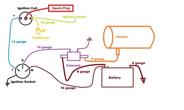

TIGman 2,006 #9 Posted July 20, 2016 The next thing I'm going to do on 875 is see if I can get the Kohler K181 to fire up. Going to use the wiring diagram 953 nut shared and use a solenoid in the start system. A solenoid came with all the parts in the C-120 deal . 2 Share this post Link to post Share on other sites
