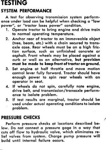

pfrederi 21,215 #11 Posted July 17, 2016 Do you have pressure gauge? The manual initial test is to get her warmed up thean tie her to an immovable object with the rear wheels on cement or asphalt. She should be able to spin the rear wheels with you on her. If not then a pressure test would be in order. If she fails that then .... I doubt 10-30 vs 10-40 would make a huge difference especially before they got hot. http://www.wheelhorseforum.com/files/file/1494-transmission-hydro-eaton-11-sm-492-4205pdf/ 2 Share this post Link to post Share on other sites
scotty 252 #12 Posted July 17, 2016 No improvement. I tried the hydro test and it did not even try to spin the tires. All it would do was sit there and whine. Now i think im going to have to figure out what i want to do with it. Thinking about putting the 16 hp onan on another frame with a gear drive. Share this post Link to post Share on other sites
