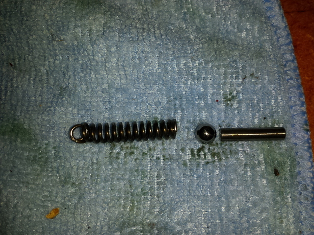

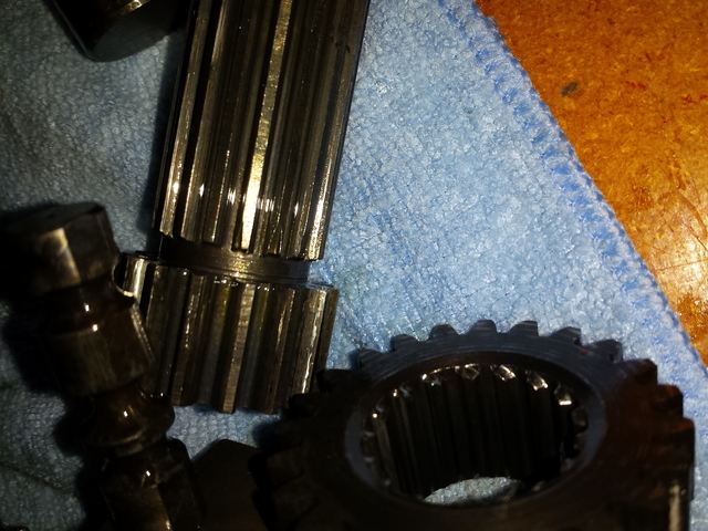

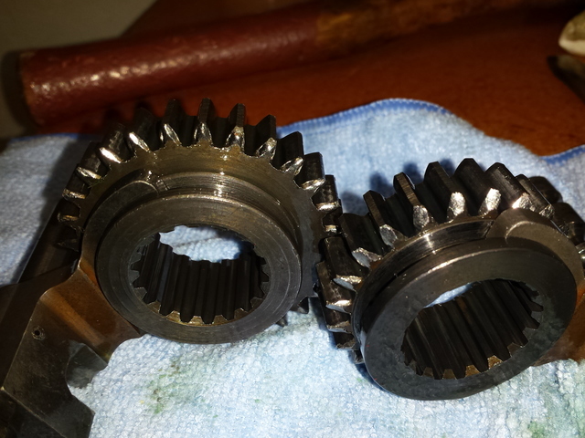

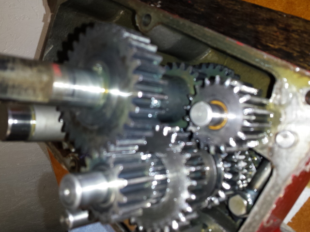

moe1965 770 #7 Posted July 16, 2016 (edited) I'm missing a detent ball. I'm still looking. The spring is bent on the end Here are a few pix Edited July 16, 2016 by moe1965 1 Share this post Link to post Share on other sites
Racinbob 12,510 #8 Posted July 16, 2016 More, you're doing great and you have the best helping you. I think I can fix you up with that spring. The balls are hardware store 1/4" balls but I should have those too. Let me verify tomorrow. Take care of that pin. It should be 3/4" long. The spares I have are 11/16" and, you need the longer pin. 2 Share this post Link to post Share on other sites
moe1965 770 #9 Posted July 16, 2016 Thanks racinbob I guess im to blame for the issues. I bought the tractor back in january at a auction house not running. got it running shortally after that. totally took it apart and repainted it and tinkered with it when i had time. I assembeled it to the point i could start it up and go through the gears etc... at that point i didnt have the belt gard on and didnt realize it is necessary to have on to stop the belt.. any how i forced the high low gear and exploded it. I opend up the trans replaced the gear and had one heck of a time getting those detent balls in. finally success the shifter never really felt right to me but it did work. i mowed for 3 hrs with it mostly in second but then my current issue poped up. My question would be do you think that second detent ball never ended up where it belongs and just the end of the spring was falling into that detent in the shifter rail... if so where did that other ball go? I couldnt find it anywhere.. I hope it fell out when i split the trans and it ended up in the cardboard and paper towels i had set down on the bench. i took it to the burn barell and set it a blaze so there is no way to verify if it was in there... Im sure with everyones help i will get this figured everyone on this forum is very helpful and i cant say that enough....... Im not upset with myself for trying to fix things and fail.. thats how I learn. It better than playing Pokemon Thanks again john Share this post Link to post Share on other sites
stevasaurus 23,536 #10 Posted July 16, 2016 (edited) John, excellent pictures. Your gears look OK. I would take Bob up on the spring and balls. If you have a pencil magnet check for the ball in the bottom where the shift rails go. My guess, it never made it in there when you rebuilt it and you threw it out. You didn't tell me that you had already been into that trans a couple of times. You should be good to go now though. You can see that your brake drum is on your cluster gear shaft. You have the 8 speed #5073 transmission. Another thing...you can not jam the gears in the 8 speeds if you have both detente balls and the 3/4" stop between the rails. You can when a ball is missing. This will solve that issue also. Tip: use a 1/8" or 3/16" Allen wrench to hold the detente ball in place while sliding the rail past when you put it back together. Edited July 16, 2016 by stevasaurus 2 Share this post Link to post Share on other sites
Racinbob 12,510 #11 Posted July 16, 2016 I'm betting it's in the shift rail hole and was causing you not to be able to get it fully in reverse. Where it would have fallen would be the right spot to cause that. PM me your address John. 1 Share this post Link to post Share on other sites
Racinbob 12,510 #12 Posted July 16, 2016 One more thing when you get the spring and balls. The 3rd/2nd rail (the one to the rear) must be in the neutral position before you can push the second ball in far enough to get the rev/1st rail past it. 3 Share this post Link to post Share on other sites

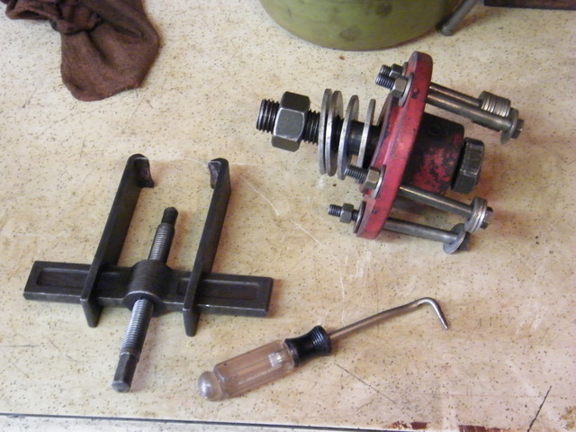

stevasaurus 23,536 #17 Posted August 2, 2016 (edited) No, that is for the 1 1/8" axle. The 1" axles are SKF 9815. You should have the 1 1/8" axles. To change out a seal, I use a smaller blade screwdriver and rip a little of the rubber and seal by tapping the screwdriver down along side the seal with about 2 taps with a ball peen hammer. Then I can get my cotter pin pulling tool and get behind the seal and just pry it out. Remember, the seal is only about 1/8" thick. The tool in the bottom right in this pic. Edited August 2, 2016 by stevasaurus Share this post Link to post Share on other sites
