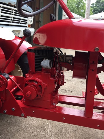

AlwaysLookin80 1,308 #1 Posted July 14, 2016 Just finishing up a full resto on my 1960 suburban and I was wondering if someone can give me the correct belt size and info for the trans to engine belt. I need a new belt and it didn't have one when I got the tractor. Thank you. Share this post Link to post Share on other sites

russellmc301 601 #5 Posted July 15, 2016 30" is what i got Share this post Link to post Share on other sites
Skeeters65 46 #6 Posted September 1, 2016 Is it just a standard 30" V Belt you can buy at Tractor supply? Share this post Link to post Share on other sites
Racinbob 13,250 #7 Posted September 1, 2016 The WH #1569 is 28.95" x 1/2" wide. I ended up using a 30" also. Tractor Supply is fine but I'd suggest a Kevlar covered. Share this post Link to post Share on other sites
WHX?? 58,323 #8 Posted September 1, 2016 29" for sure ..I also got a 30 and a 28 to save another special trip but the 29 worked best & took the other two back. ACE hardware What you should do @Skeeter65 is start a thread in resto & mods, call it skeeter's resto, that way all us 400 fans can follow it help you out from there. You are going to need to spend 20 bucks here http://www.wheelhorseforum.com/store/product/2-1-year-redsquare-support/ so as we can check out all the you post! 1 Share this post Link to post Share on other sites
Racinbob 13,250 #9 Posted September 1, 2016 A dedicated thread is definitely the way to go. It weird Jim. I know it's supposed to be a 29" but that was way too tight. Even the 30" seems a bit tight. I've got the motor off right now but when I put it back on I need to do some investigating. Share this post Link to post Share on other sites
