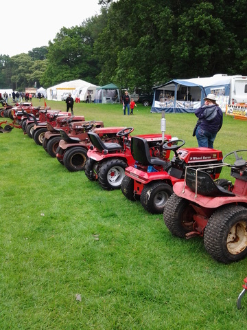

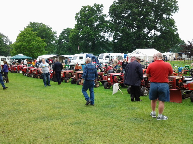

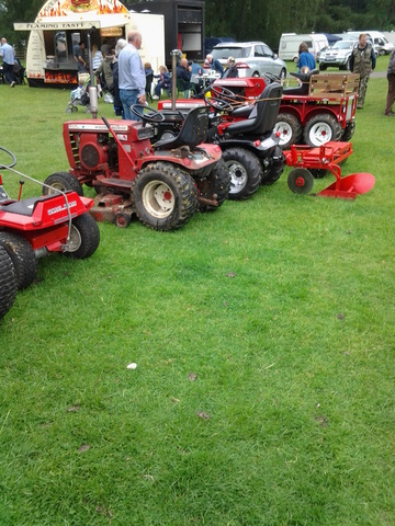

Chantry 1 #8 Posted July 14, 2016 Hi Garry, Many thanks again for your help and assistance - I'll let you know how i get on. I know the machine as I was at a tractor festival a couple of weeks ago in the North of England at a place called Newby Hall - as you can see from the few photos I have attached, amongst many other makes there were quite a few Wheel Horses on display, which made for a very intersting few days. Thanks again, Chantry 1 Share this post Link to post Share on other sites
